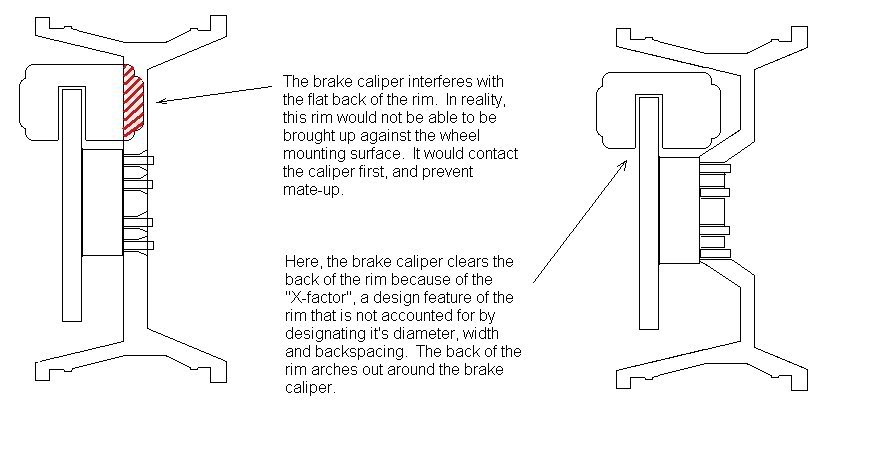

    boom, found you an image (see below). If the image ever disappears on a future reader, basically search for 'rim x factor'. It's the measurement between the mounting surface and the backside of the rim face.
    The La Paz rims have too small of an x factor.
    Additionally, I would consider two more things:
    • When buying rims, make sure the center bore measurement matches. On Toyota, that measurement should be 106.1mm. Most rims out there are 108mm, which means you need a small shim to keep the tire centered. No thanks! I had a hard time finding anything that would have a correct x factor and also have the correct center bore, so that's why I went with SCS.

    It's amazing how much that image helped me understand wtf was going on. It also makes sense as to why 4wheel would recommend certain wheels that have the same offset and backspace. It's just the rim shape itself conflicted with the caliper. Scs are nice wheels, just a tiny bit outside of what I'm wanting to pay right now. I'm going to go in and talk to a 4 wheel rep in person and figure this out.
