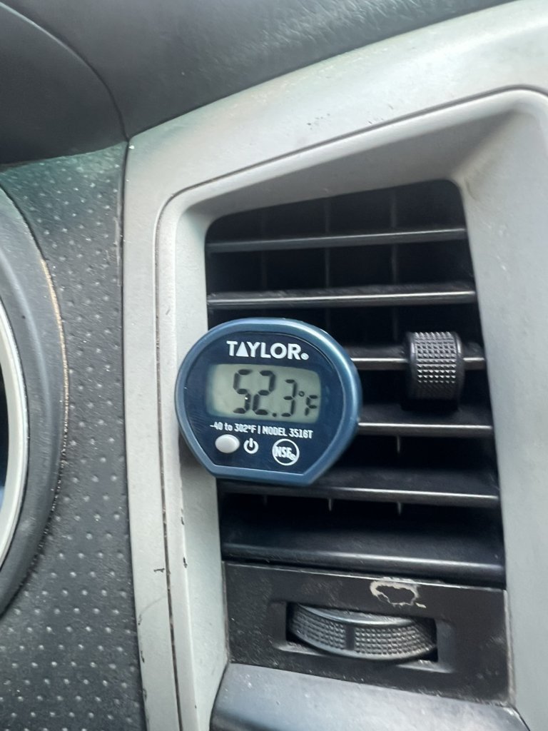

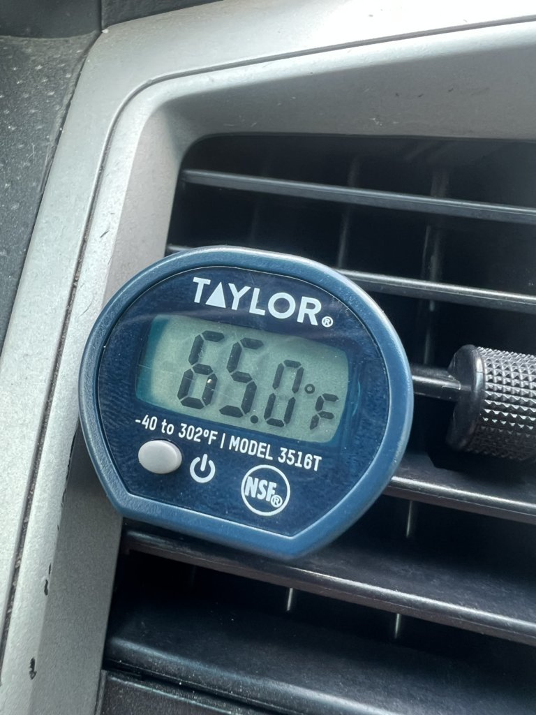

    I recently rebuilt my entire AC system as my truck didn’t have one when I bought it. I replaced everything except the evaporator and expansion valve. I ran the vacuum, made sure there’s no leaks, filled it with 22oz of R134a.
    It works but when I’m parked it gets about 60-70 degrees Fahrenheit. When I’m driving on the highway after 10 mins, it gets down to 52 degrees Fahrenheit.
    I live in Texas and it’s getting insanely hot. What could be the issue with my system? How can I get it blowing ice cold even at idle?

    It seems to get ice cold at night, early morning or on days when it’s not so hot. It’s usually when it’s the hottest part of the day that it has a harder time getting ice cold.
    I spun the fan clutch and it does get resistance. But I may replace it anyways as it’s original to the truck.
    I did get access to the expansion valve, unfortunately one of the screws stripped so I had to leave it alone. If the expansion valve is the issue, I’ll have to take apart my entire dash to get the stripped screw out but not before I empty out the system.
    What do yall think I should do first?
