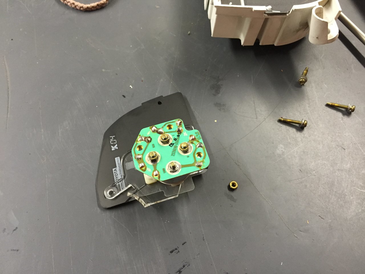

  4. Aug 9, 2017 at 5:47 PM
    BossFoss
    BossFoss If your over 40 feet back, you ain't suspicious.
    Nov 14, 2014
    #142355
    3,067
    Wyoming
    01 DC Tacoma
    Check the back of your guage. (Take out cluster then separate plastic front from back to be able to pull it out). I had the nut in the pic come loose so the gas gauge read empty even though it had gas.
