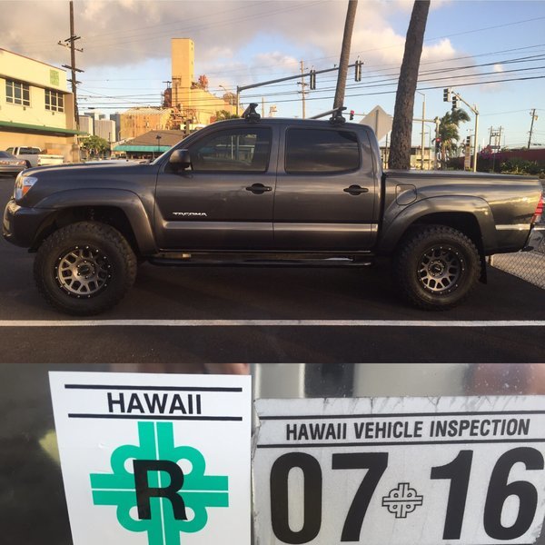

    Mike, you were right! No need for Bushwacker fender flares! Passed recon with my set up yesterday.
    Original fender flares and original mud flaps. Pro Comp Nitro 3" lift leveling kit (spacers, 3" in front, 1" in rear).
    285/70R17 MT Baja ATZP3's wrapping Pro Comp Vertigo grey series 40 wheels with -6 offset and 4.75 back spacing.
