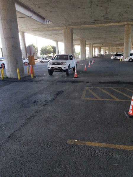

    Passed. Was crowded.20161116_085102.jpg.

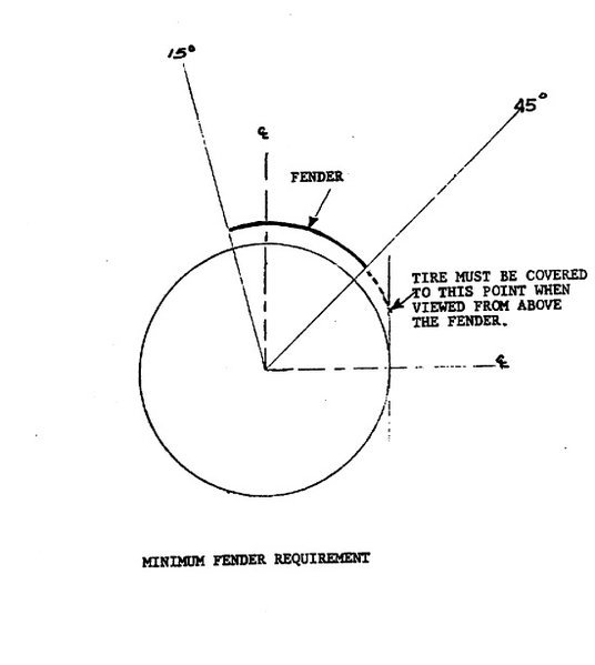

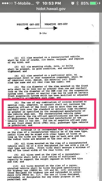

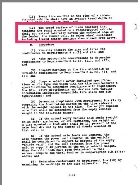

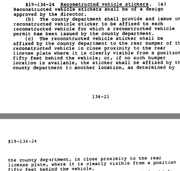

    Thanks for the replies! I dug a little info up from the hi.gov website and found a few things on there that i thought would answer some questions about spacers, protruding tires, and recon sticker placement! All questions that i had that were clear as mud! Hipe this helps! Granted all this stuff was drawn up in 1986..IMG_3635.PNG.jpgIMG_3636.PNG.jpg IMG_3637.PNG.jpgIMG_3634.PNG.jpg

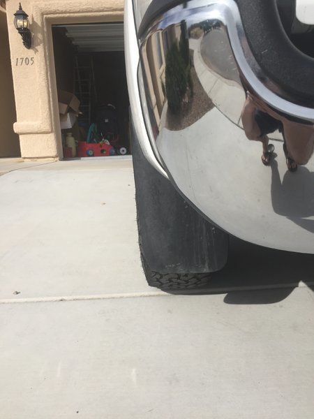

  20. Jan 23, 2017 at 9:41 AM
    #900
    k3v11n
    k3v11n Yeah? No!
    Mar 30, 2015
    #152106
    1,285
    Oahu, Hawaii
    2015 SR PreRunner Oahu Edition
    PlastiDip
    They failed me when my tires were like this. Lol
