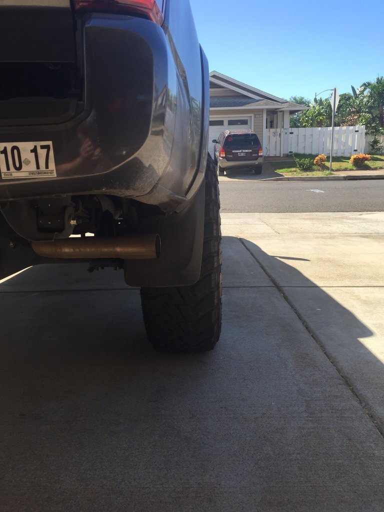

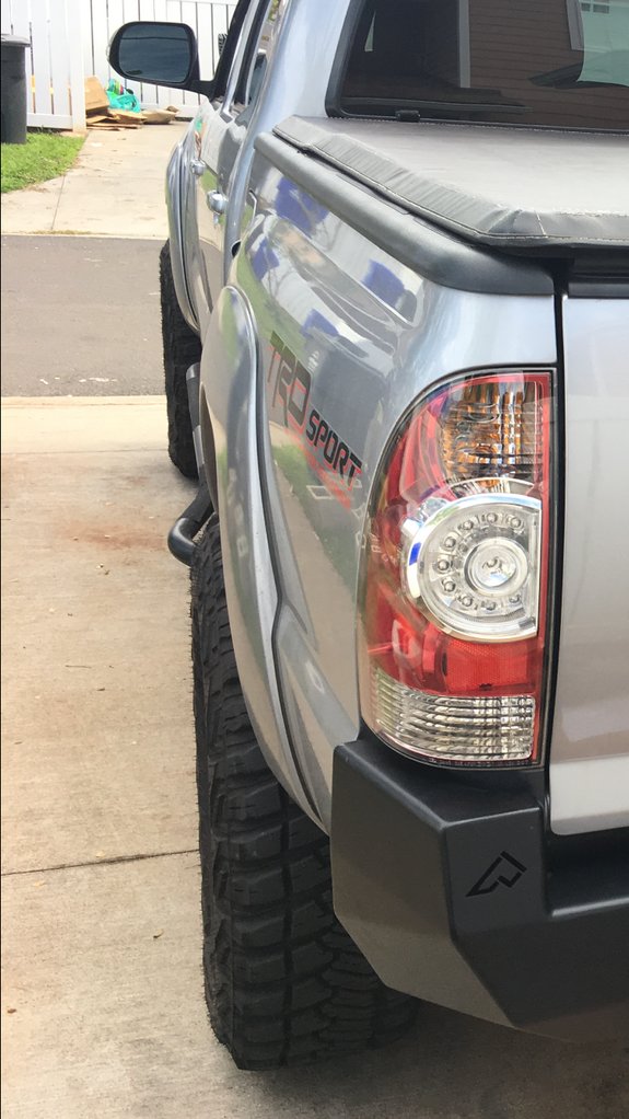

    Would I pass recon without flares?

    My tires stick out exactly like that An i passed.
    kakwvu and trdizzle[QUOTED] like this.

    Mines stick out da same cuz of the sidewalls. But I put flares on just cuz you never know what they'll say. A guy checked mine, but when a lady came out to put my sticker on I asked if would've been ok without and she said I would've passed.

    Well mines was just the sidewall sticking out. The main tread of the tire itself, just like trdizzle's pic above, just made the clearance of the fender flare. So I suppose that made it acceptable... or would've cuz I added extended flares anyway.
