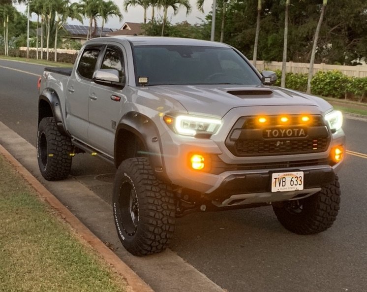

    Better to go legit! I can drive in Waikiki anytime and no problems. Everything on my truck is GTG!

    your truck is mean! i work in ala moana and go through waikiki/chinatown every so often with no problem right now with the only thing being illegal my tint. will probably end up making fronts legal after so if i do end up getting pulled over and ticketed for tires tint won’t get added on.

    For real, sometimes it is just not worth the hassle. I try to keep list of violations to a minimum and not drive like a douche.
    But, if some cop was really technical and wanted to be dick, you have more than 4 forward facing lights that are exposed. Even if not turned on, headlights, driving lights, and the hood lights make 6. You're supposed to have covers. I highly doubt you would get pulled over for just that if they weren't on, though. But I see idiots with light bars and LEDs on while driving on the road, and funnier when its daylight.

    Toku what size rims and tires are those (any spacers). And what kind of flares did you get to help you pass recon?

    The rims are 18x10" 4.5" BS and spidertrax 1.25" spacers. The flares are Lund. They are wider then the BW flares. But remember it also depends on the Brand of tire you get also. Without the spidertrax it would have passed easily!

    So you sticking out about 1.25 and the lund covers it well.
    Think the lund would cover 2" from from fender???
    Also thanks for the info. Effing recon is stupid.
    BTW your trunk is really nice. Clean look.

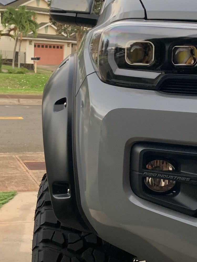

    With the stock flares and no spacers the tires stuck out about 7/8" almost 1".
    Now with the 1.25" spacers and the Lund flares the tires are 1/8" under the flares. (The part that makes contact with the ground) The side walls stick out of the fenders. So by those results, I think the Lund adds approximately 2.25" of additional coverage over the stock flares.
    Hope this helps!

    Thank you so much for the info. This is exactly what information I was looking for.
    Looks like I'll be grabbing me a set of Lunds.

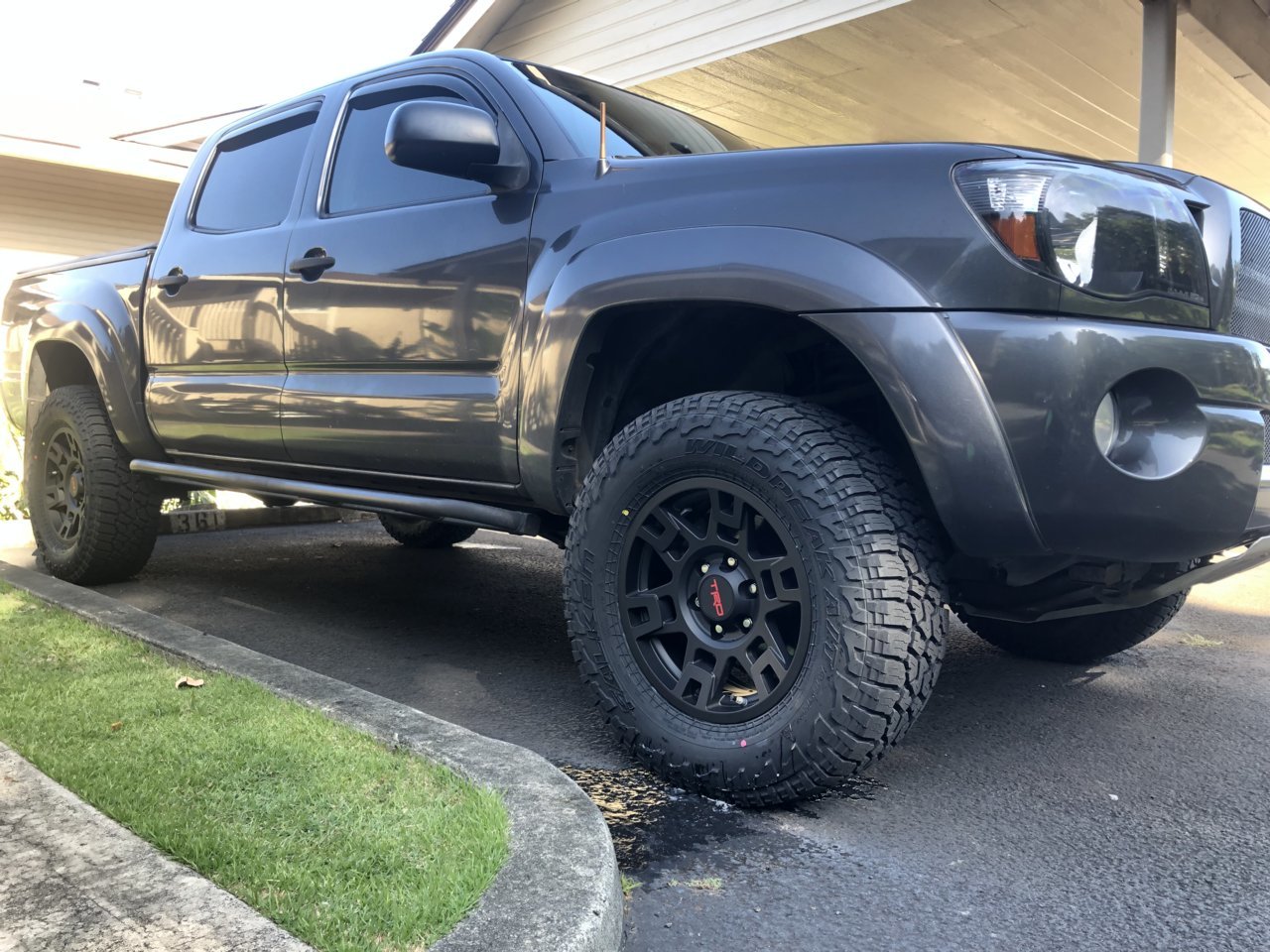

    Finally got my bumper. If I get time to mount it up this weekend. What's the time I have to get to recon? I'm sure the cops dont care since I already have recon just getting an update. But dony want to get a ticket. Also when updating recon are they gonna require me to get another alignment?
