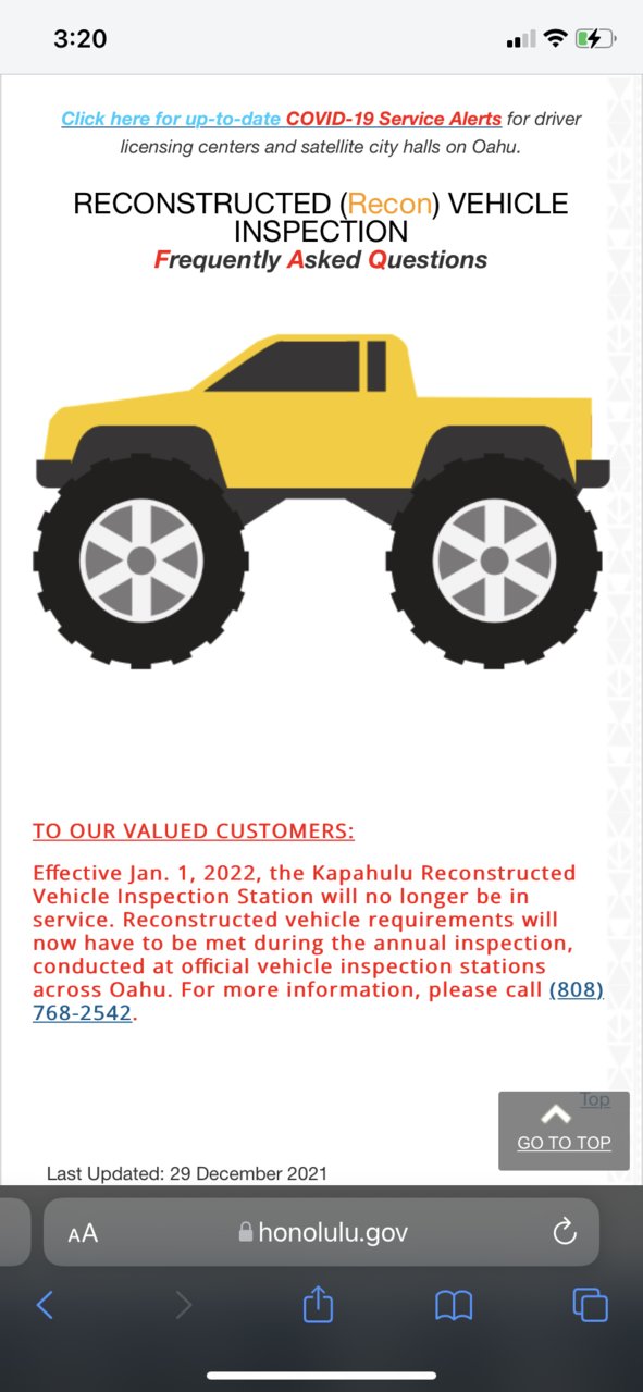

    Seen this on the state website. Recon inspections will be done during safety checks? Anybody have any more info?
    seoulja99 likes this.

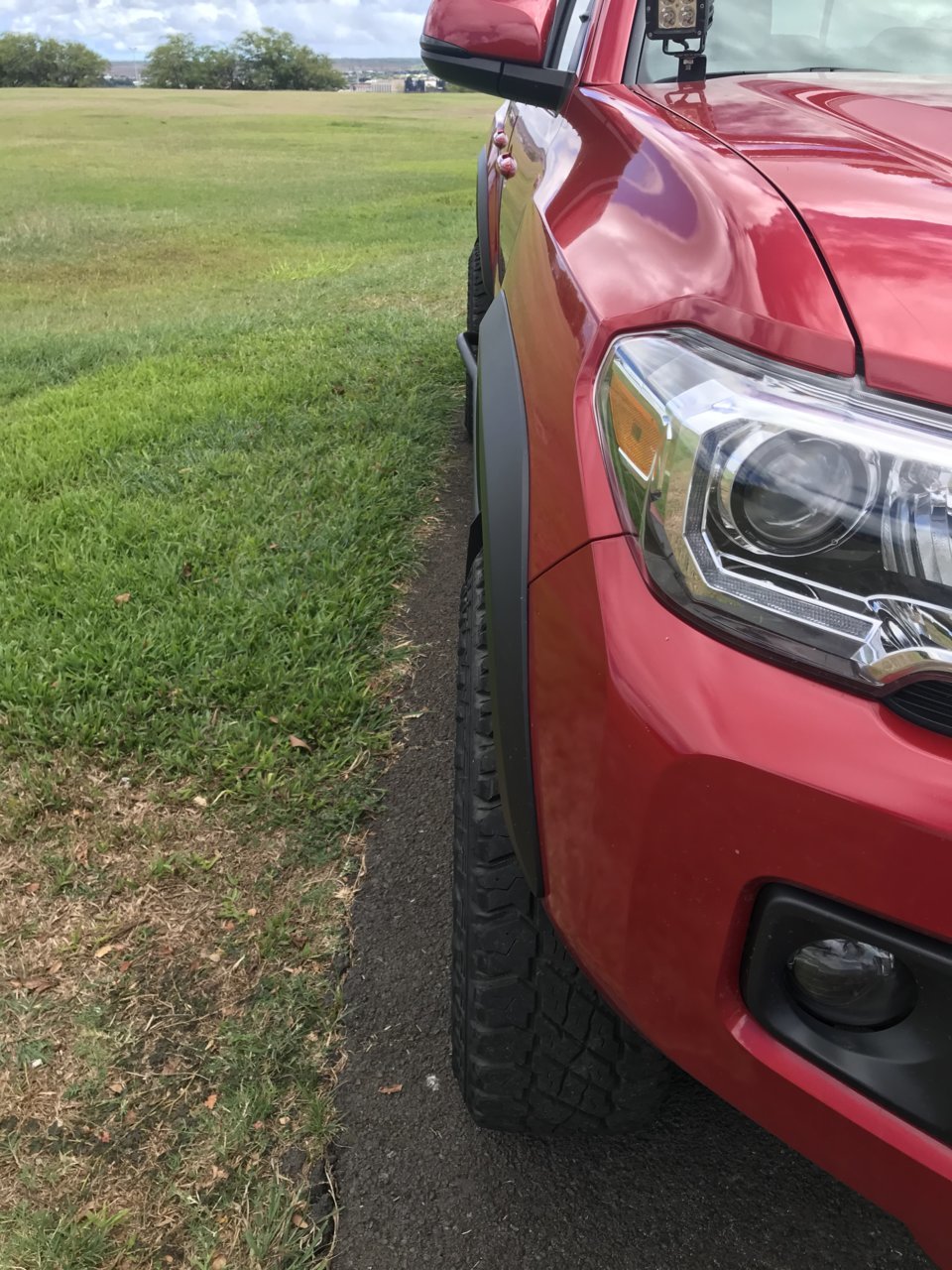

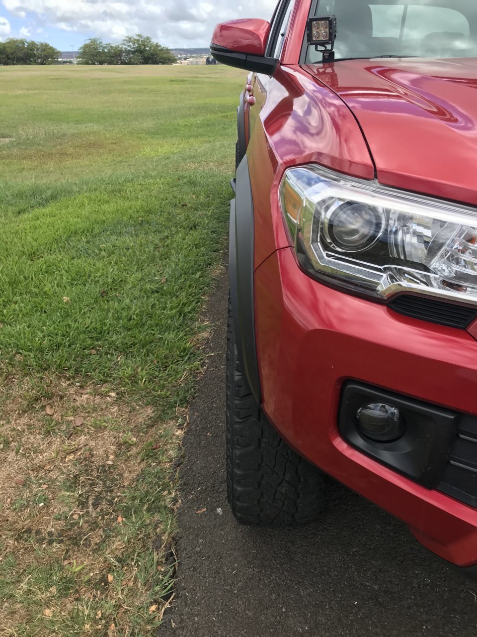

    Wow even this little of a "poke" wouldn't pass? I better plan on installing these extentions
