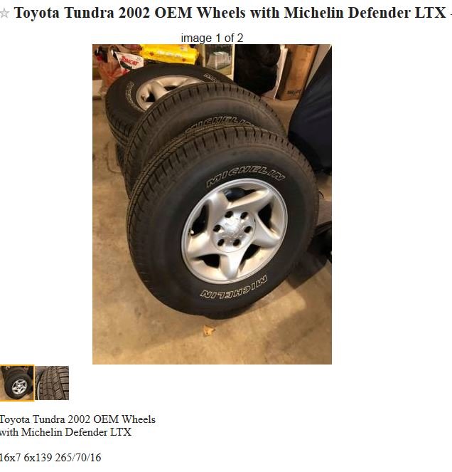

    i know haweka adapter is required when balancing 3rd gen toyota tacoma wheels, however is it required to be used when balancing 1gen 6 lug wheels (pic below)? i took my 2002 taco to a tire shop today and they balanced it without the haweka adapter(my chief complaint was when driving in the range of 50 -70 mph the steering wheel is throbbly/vibrating). after balancing problem has not been solved so i started doing research online and learned about the haweka adapter. i called the shop back and asked if they used it and their response was " we have that adapter but that adapter is not needed for your kind of wheels". hence starting this thread to validate if 1. 1st gen wheels (pic attached) require the use of haweka adapter and 2. if the shop is giving me the run around and just dont want to re-do it/do it properly. thanks in advance!

    I'll hazard a guess that the Haweka adapter is needed specifically for hubcentric wheels?

    This is interesting, I have those wheels w/ 265/75’s Coopers. I’ve had them balanced at 2 shops and both places have a HUGE amount of weights, it shakes over 65 and I’m 100% sure everything else is fine.... hmmmmmm

    It is needed, especially for the 6lug steel wheels, then it’s a necessity. Most place seem to be able to get the alloys close without it, but you’ll always have better results when it’s used. The problem is finding a place that has it. My local Toyota dealer said they heard of it but weren’t sure they ever had it. It was part of a special tool package every dealer got.

    On my 96 I needed the finger lug adapter to balance my 15 inch Toyota factory wheels. That’s the only way to get a true balance on the stock wheels. Any other adapter like a cone or such isn’t gonna give a accurate reading and the weights will be wrong.

    That is the best way to balance as it mimics how the wheel is actually bolted to the vehicle. Hub centered on back and "lug" tight.
    But in a practical sense, most shops only use it when they don't want to scratch the paint with the generic cup adapter or there is some usual feature on the wheel face that keeps the cup from sitting flat.
