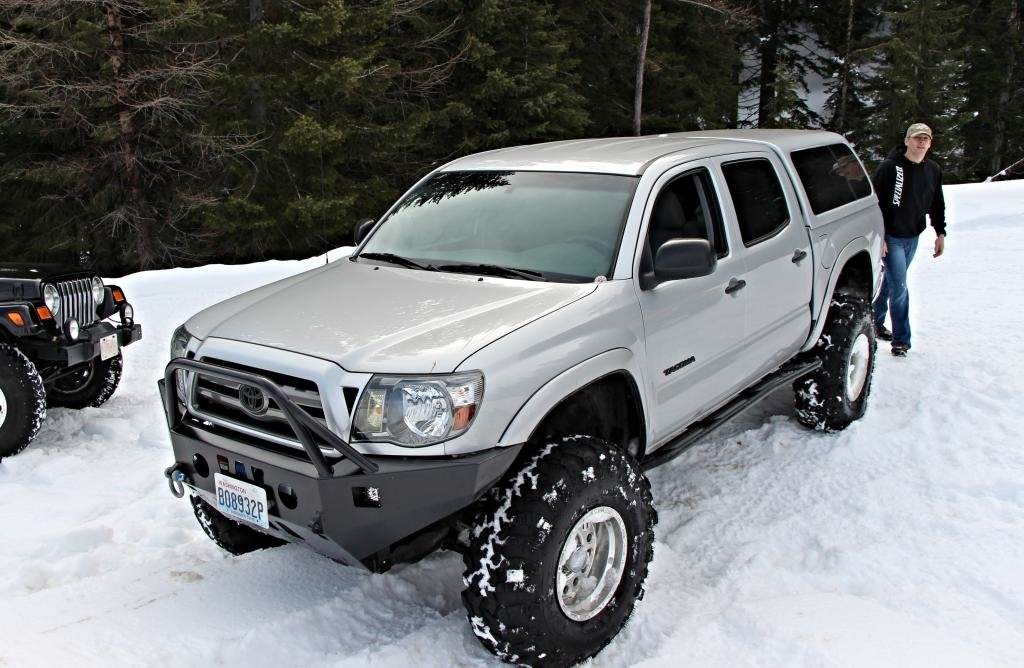

    I thought Id start here... Lurking since 2010

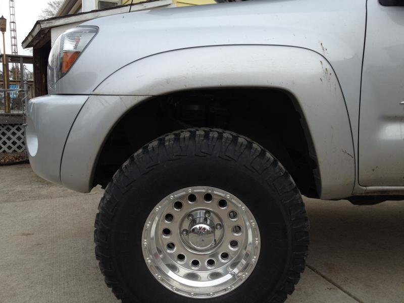

    This is kinda when the addiction began. Well after I put a spacer lift and my first set of tires (305/70R16 bighorns)
    Then:
    For Now:

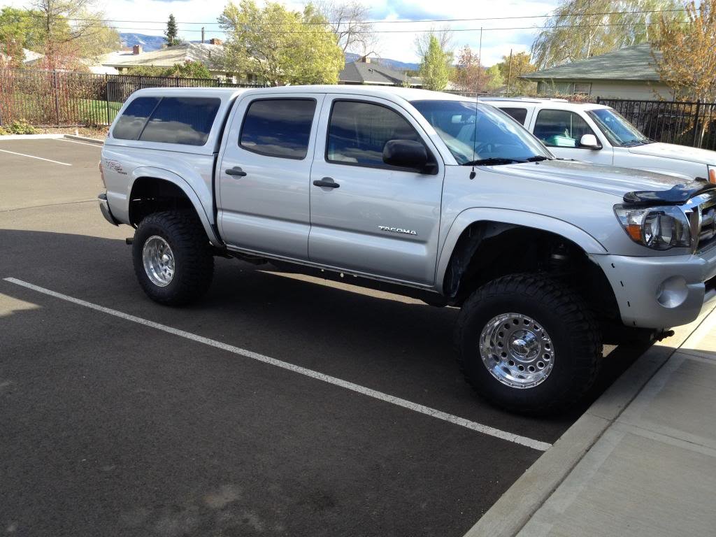

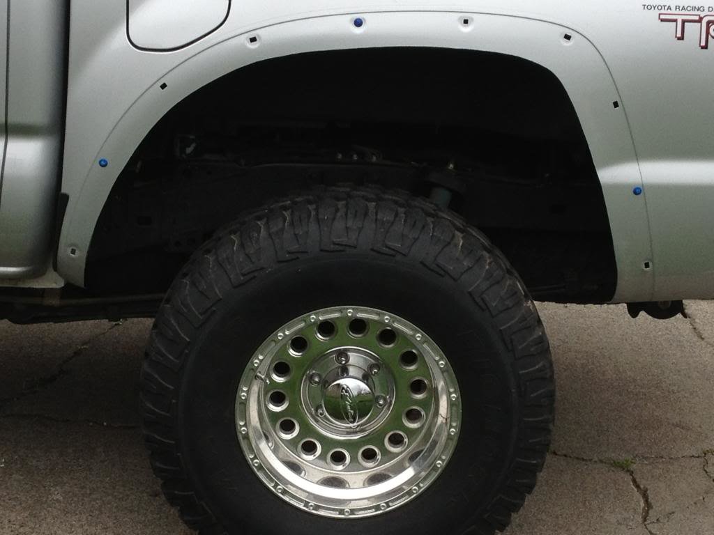

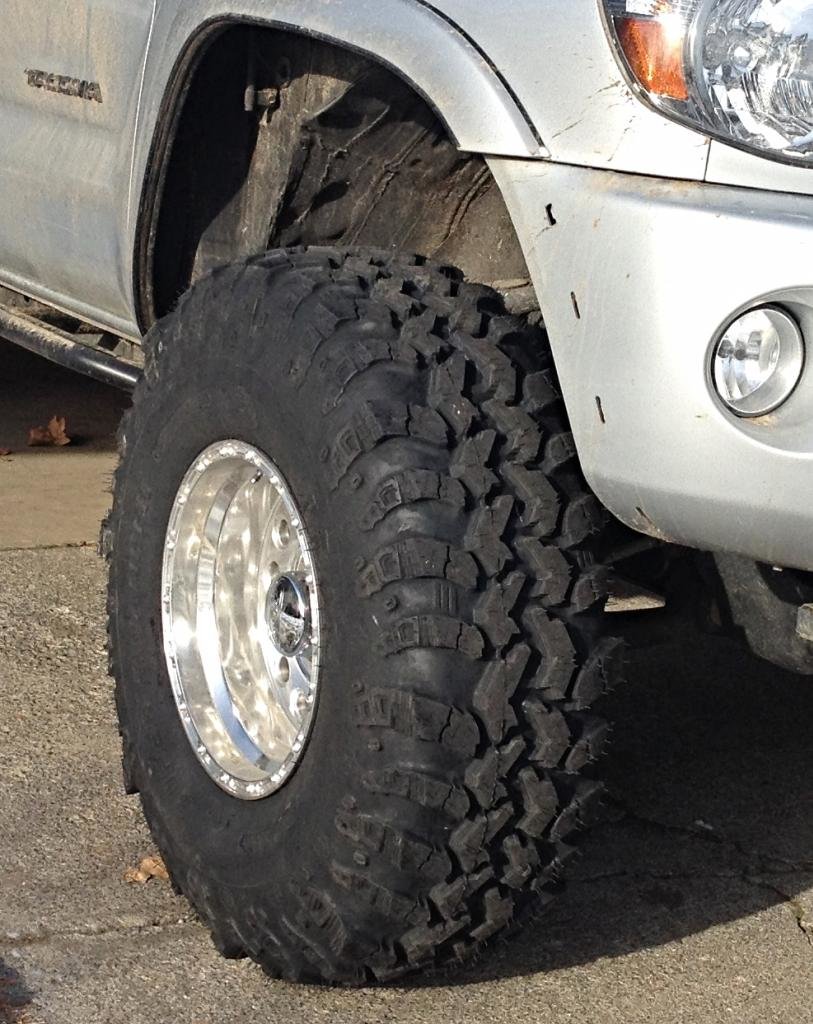

    Even with most saying it couldn't be done I started prepping for 37's
    Not these:
    These :D
    96ff16b0-ec11-4bf2-9409-cfa441310515_zps_b2e6d5f93b36c3f84568b82763ca454a0e02c519.jpg

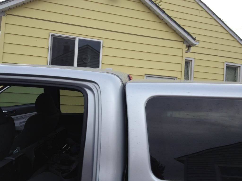

    It took a fair amount of work though
    Crawler Body lift (room for the Marlin crawl box) so shut it!!

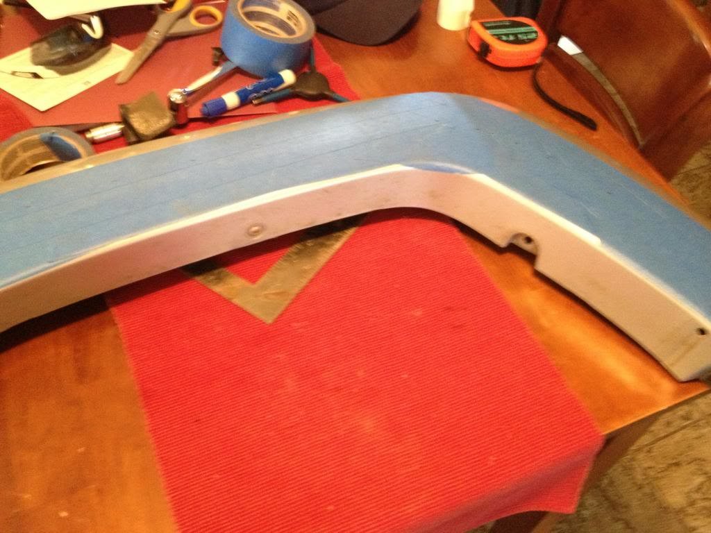

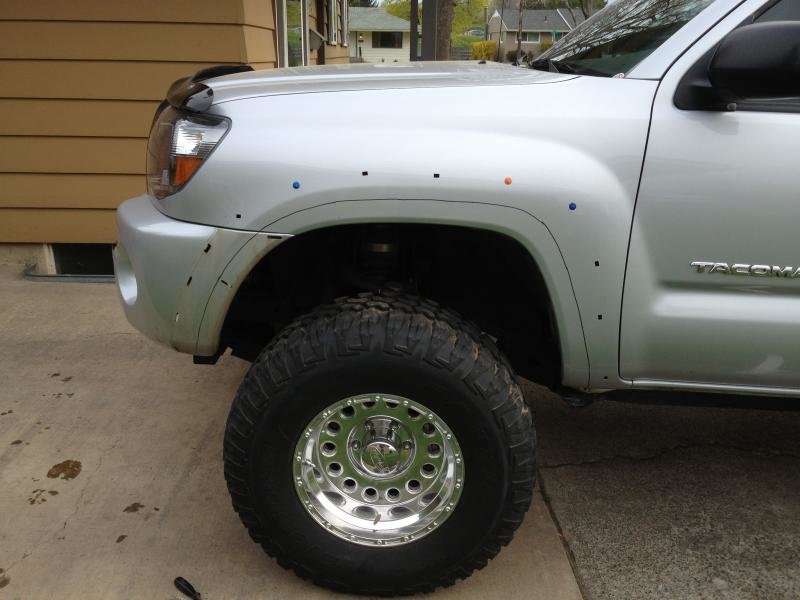

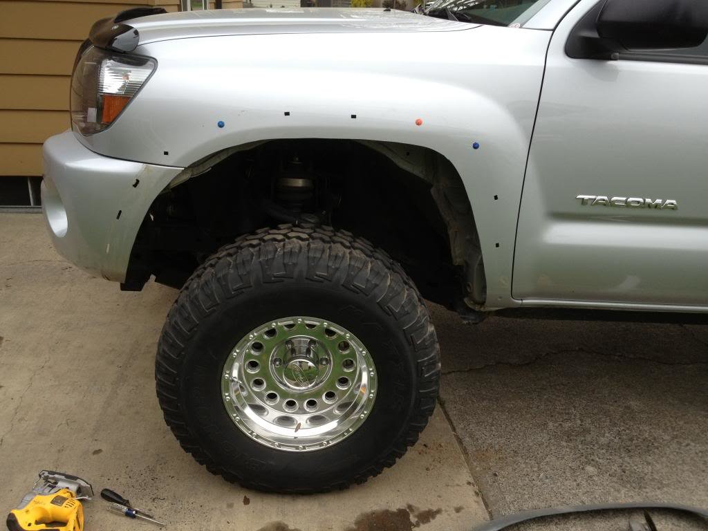

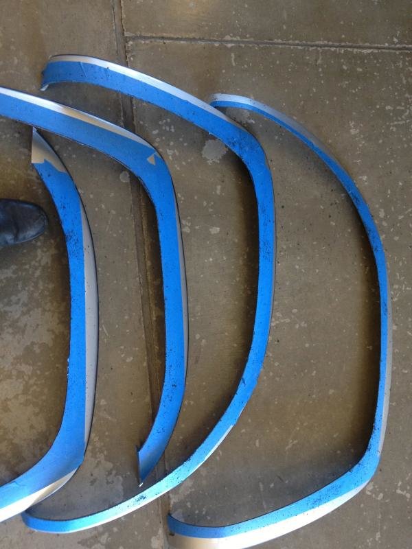

    Then some trimming

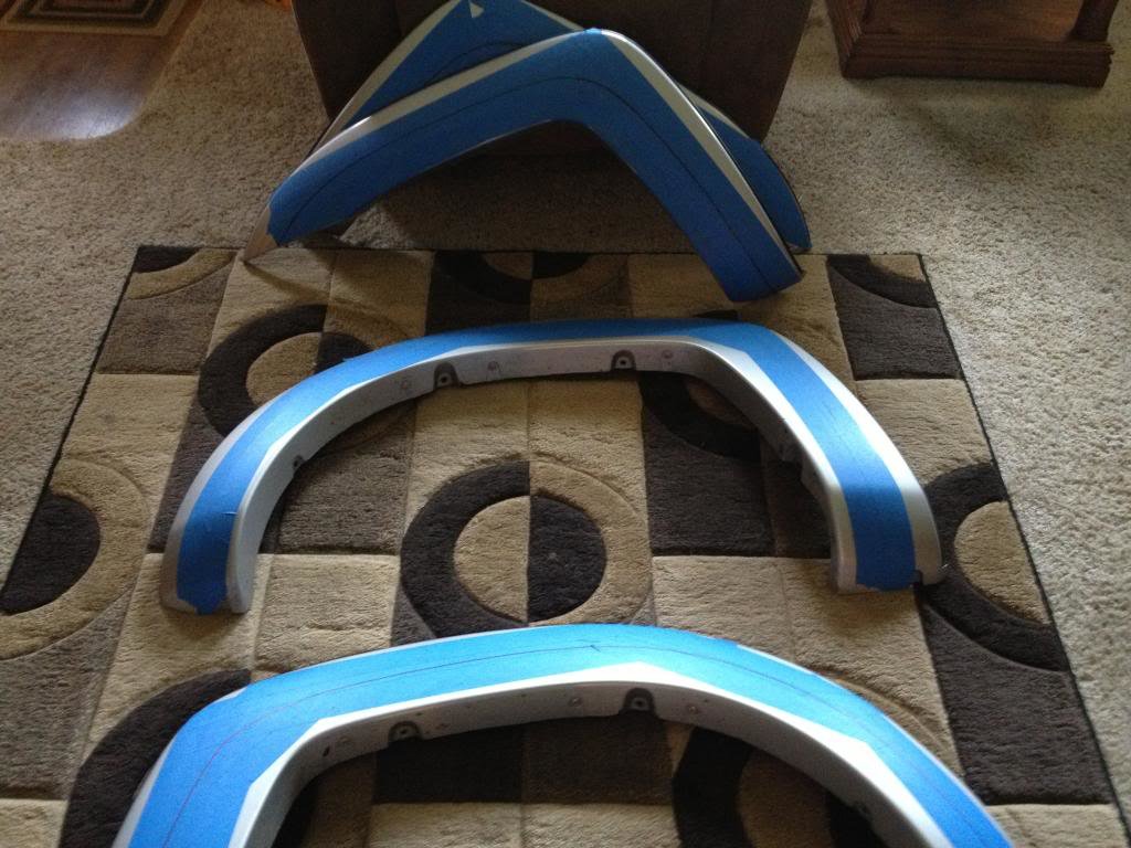

    Flares
    Yep I'm doing this
    No turning back now
    hoverlover likes this.

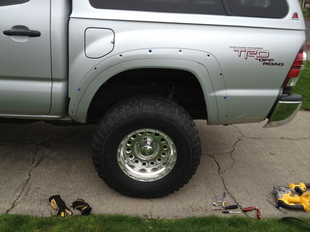

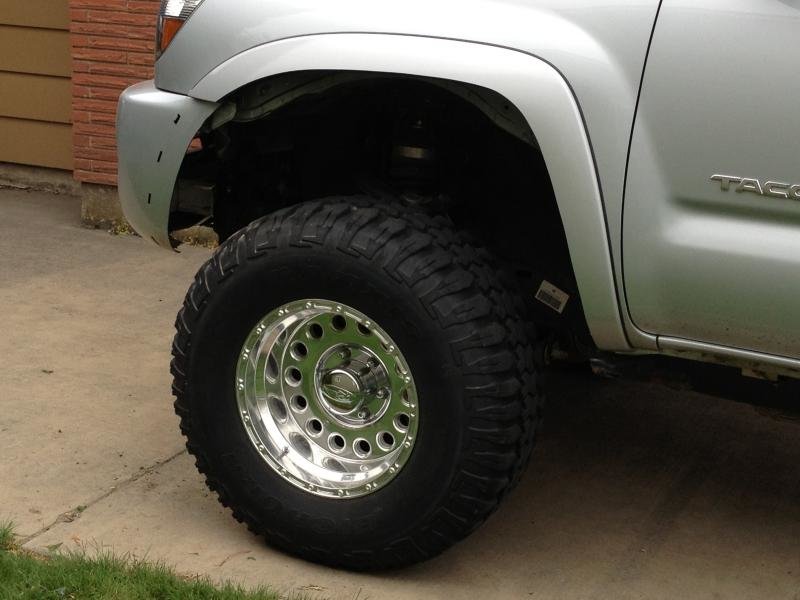

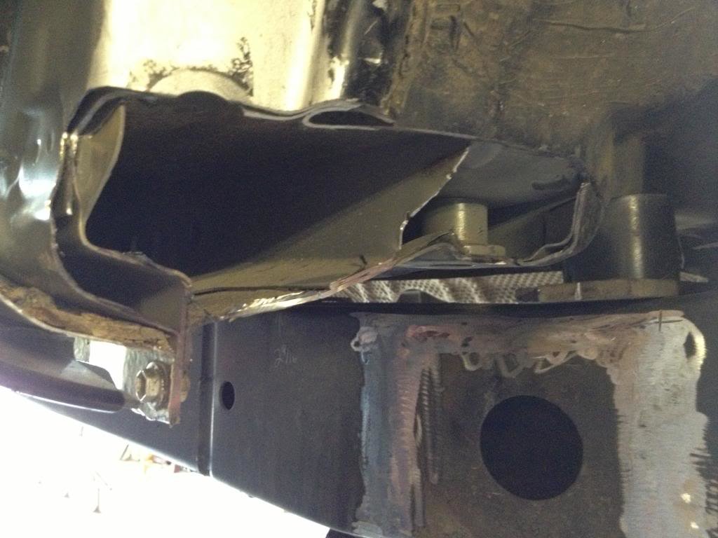

    Now time to cut some metal :der:
    And after

    Still need to do a little cleaning up but a good start

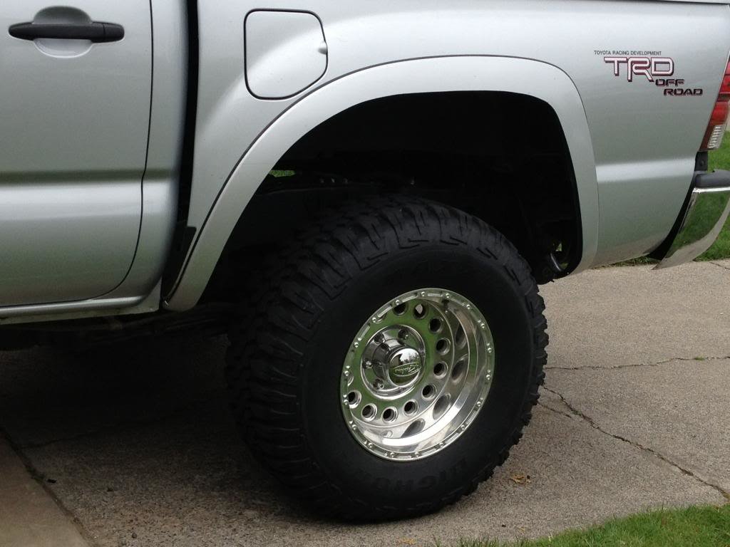

    Not quite there yet

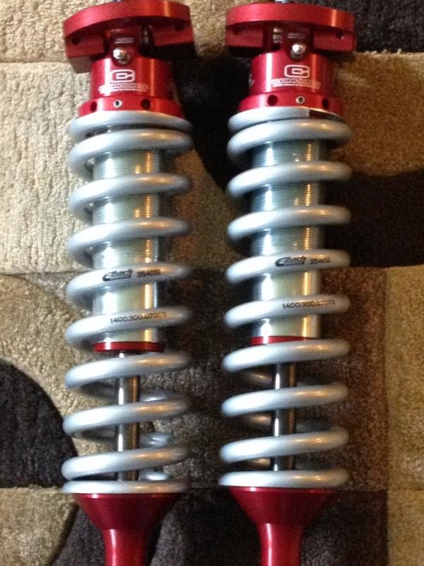

    Coil spacers suck! So I grabbed a set of these

    Haha good start man! Looking real good. I too cut my fenders. Did 2.5" all the way around.

    Pretty scary mod cutting into a new truck, but it wasn't all that bad. I did this about three years ago and am just now starting a build thread.

    Hahaha yeah bro definitely a little nerve wracking. How'd you do it? I used a Dremel. Took a while but was precise. Better late than never on the build thread! Good work.
  12. Dec 9, 2014 at 8:52 PM
    Haws
    Haws [OP] Well-Known Member
    Apr 5, 2010
    #34667
    582
    Shawn
    Washington
    TRD Off Road
    Lot's of stuff (-;
    Dewalt cordless jigsaw with new blades. Really easy to control

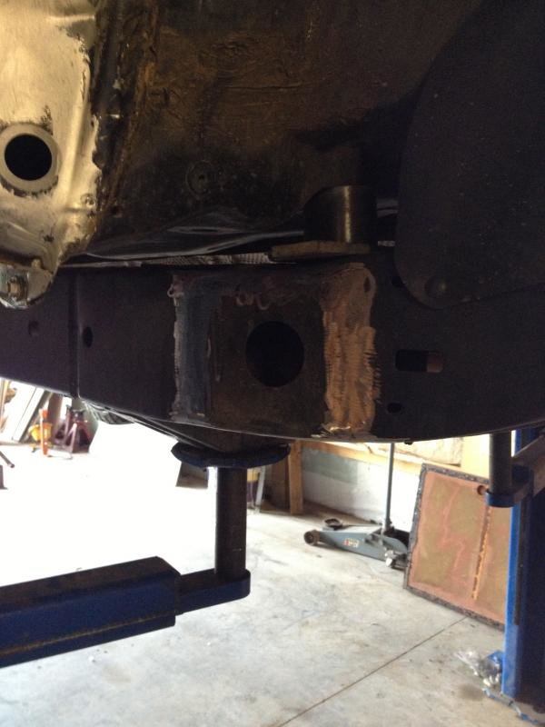

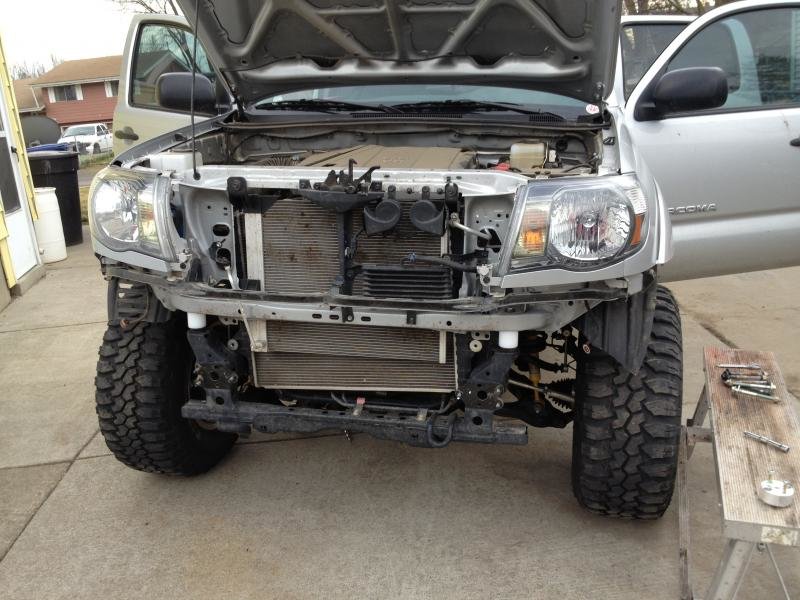

    Then there was this ugly thing thats always in the wayIMG_0272_zps1d7928d1_ff7c93938ac21caa15480f4718ce1ad59423a7a1.jpg
    So I moved it and made a few improvements
    Wonder whats behind here?IMG_0274_zpsfa956644_60e617b5828adec6084b80212024eb9ee2c0f2cd.jpg

    This was just a prototype. We Just recently revamped it after two years for an easier install.IMG_0275_zpseee9c703_c893b6c7d4346fc796fcb10faf76850d3b18d1b9.jpg
    Also got ride of that ugly body lift puck

    WAYYYYYY more room :D
    This is a test fit: 385/75/16 Toyo MT I think its close to a 38.5x15R16
    Lots of up room, but I would need to crank it up in the front and Im not a big fan of the heavy Toyo MT's

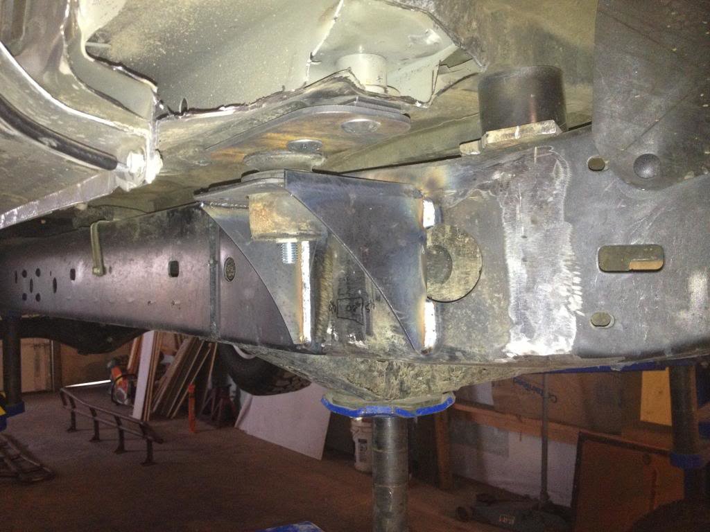

    Hmm... I hope I can put this puzzle back together

    Still waiting on a PM from you on that cab mount relocate plate, I think Craig (HomerTaco) and myself are 100% committed.

    Its finally up and moving again. He sent the CAD out to be laser cut, and then bent. We have the new updated version on the driver side now. (nothing wrong with the original just trying to make the install a bit easier) As soon and I get the passenger side back we will weld it on, and if all fits right ill ship Craig his first. Id like to wait for his install and make sure all goes right before I start taking orders.

    :yes: Well I know you would like to wait, but my cab mount is fucked lol it couldn't get much worse. But I've waited this long, I can wait some more
