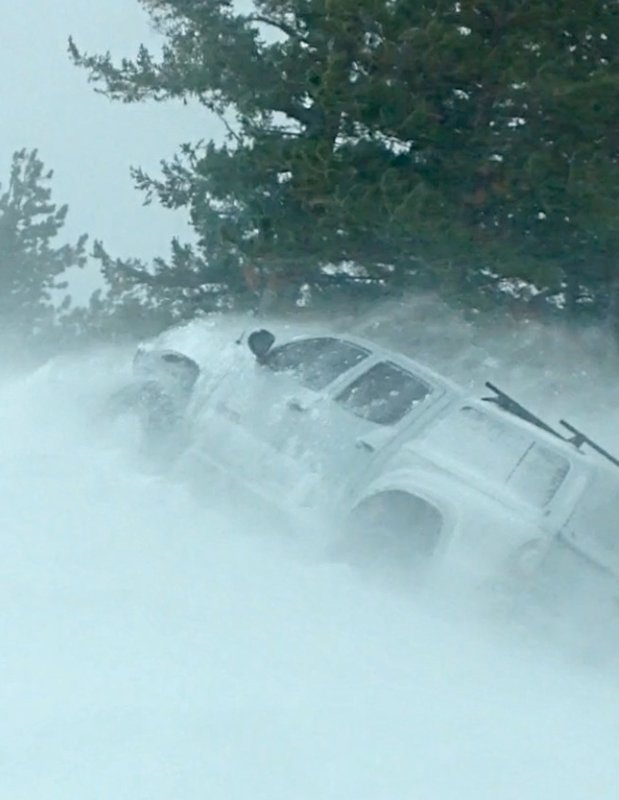

    Just in case you were wondering what 39.5's would do :burnrubber:

    To bad the video didn't capture what this drift really was like

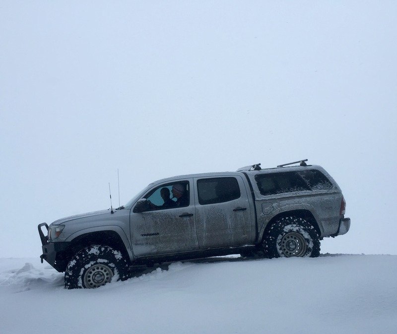

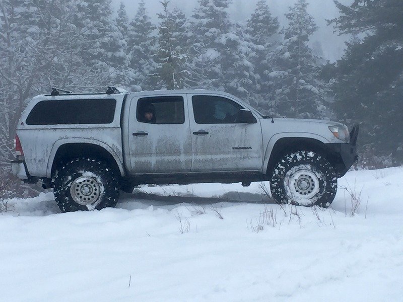

    Just a little fun

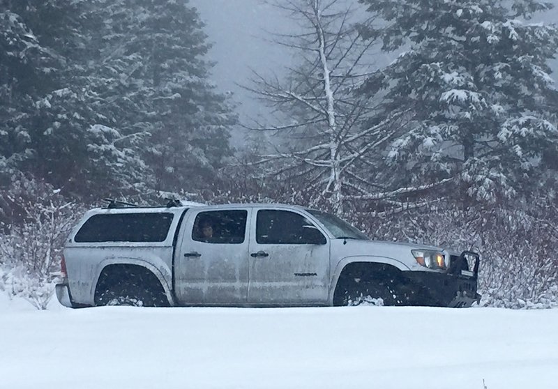

    Had a good day with my copilot

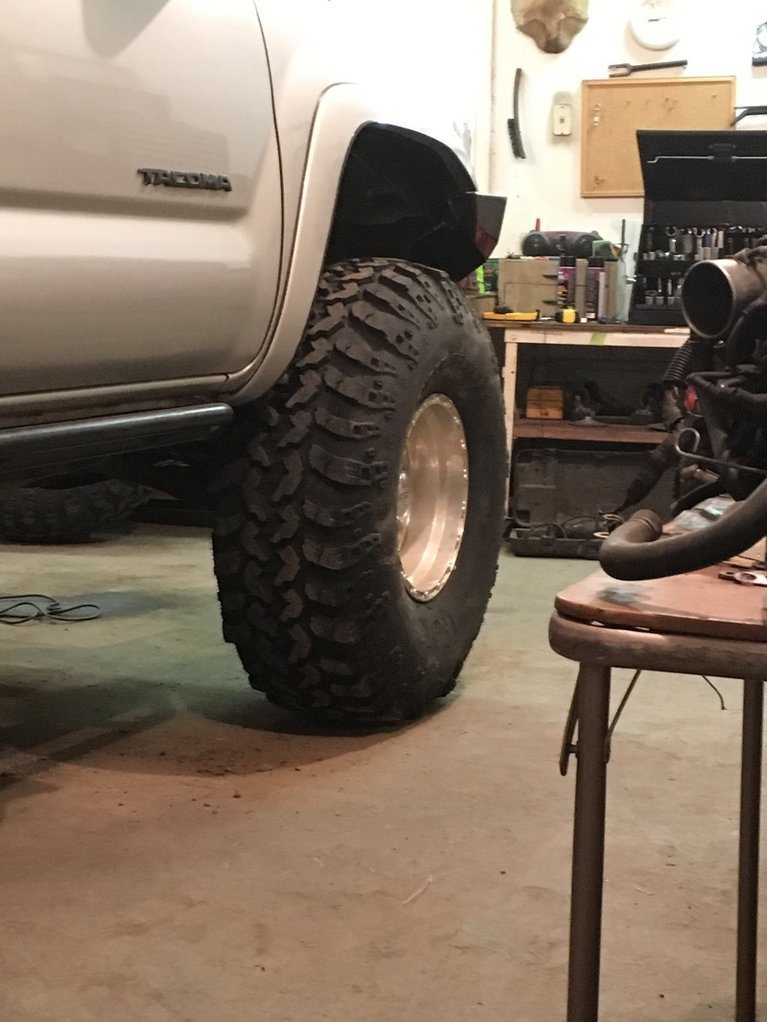

    Wow, this is a sick build! What's your suspension lift and body lift? I'm curious as to how large a tire I could stuff without the body lift.

    3" Camburg coilovers, 2" body, body mount relocated, and a bit of trimming.. (-;

    Thanks, are your coilover cranked all the way up though? Because I know a lot of people have their 3" set so that it's really more like a 2" so they aren't riding at near full droop. I'm just trying to figure out how I could get these to fit without the body lift... I think it can be done.

    No they are not fully cranked up. Im guessing 2-2.5" If you cut your flares, relocated the body mount, and trim a little it can be done. You would need to make sure you stay with the right backspacing wheel. Mine are 4.5" back spacing.
