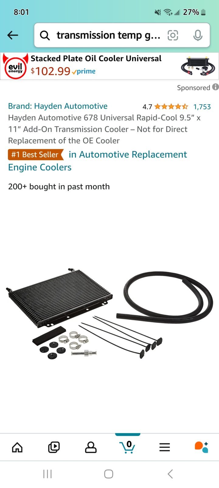

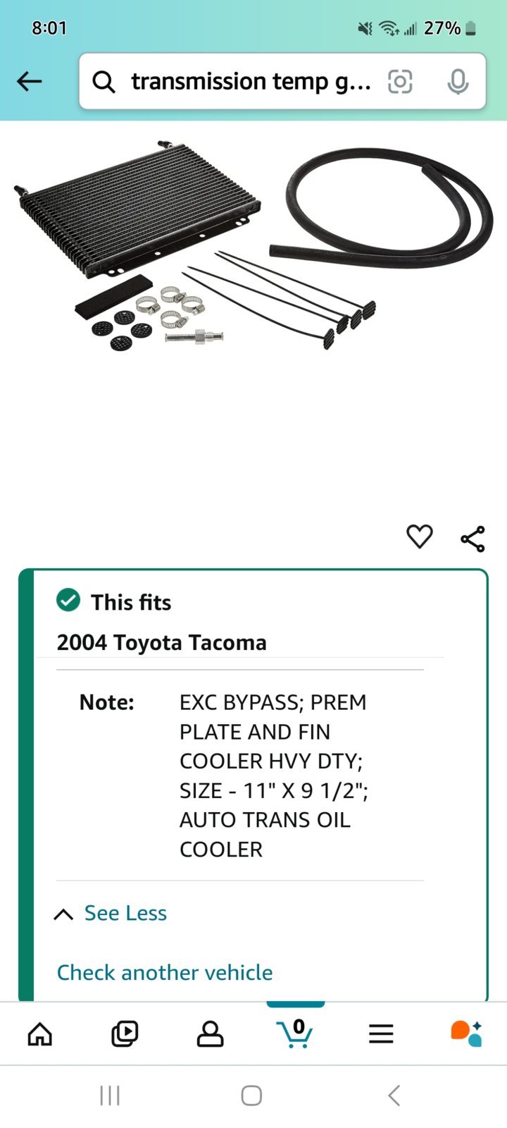

    Found a nice sized Hayden Brand cooler. 11x9.5×3.5".
    I don't know much about these 3.4 or transmissions in these Taco's. I have a 2004 with the 3.4 and no tow package. I'm not sure if this version of the Taco has a OE cooler incorporated into the radiator, like my old Jeep did. When I ran the a aftermarket cooler in my Jeep, I had to choose whether I wanted to isolate the new cooler and cut the radiator out of the picture...or run it and incorporate it back into a radiator like OE setup.
    Which method do people prefer with these 3.4 and transmission setups?
    How is this cooler for these trucks?
    Are there larger coolers for these that others have utilized?
    I have gotten temperature gauges installed in the past. Whats a good place in these trucks thats owners prefer. Typically i have gotten them installed in the fluid exit line of the transmission. Mainly so i know the temperature of the fluid in the transmission.
    Hayden Automotive 678 Universal Rapid-Cool 9.5” x 11” Add-On Transmission Cooler – Not for Direct Replacement of the OE Cooler https://www.amazon.com/dp/B000C3DDKO
