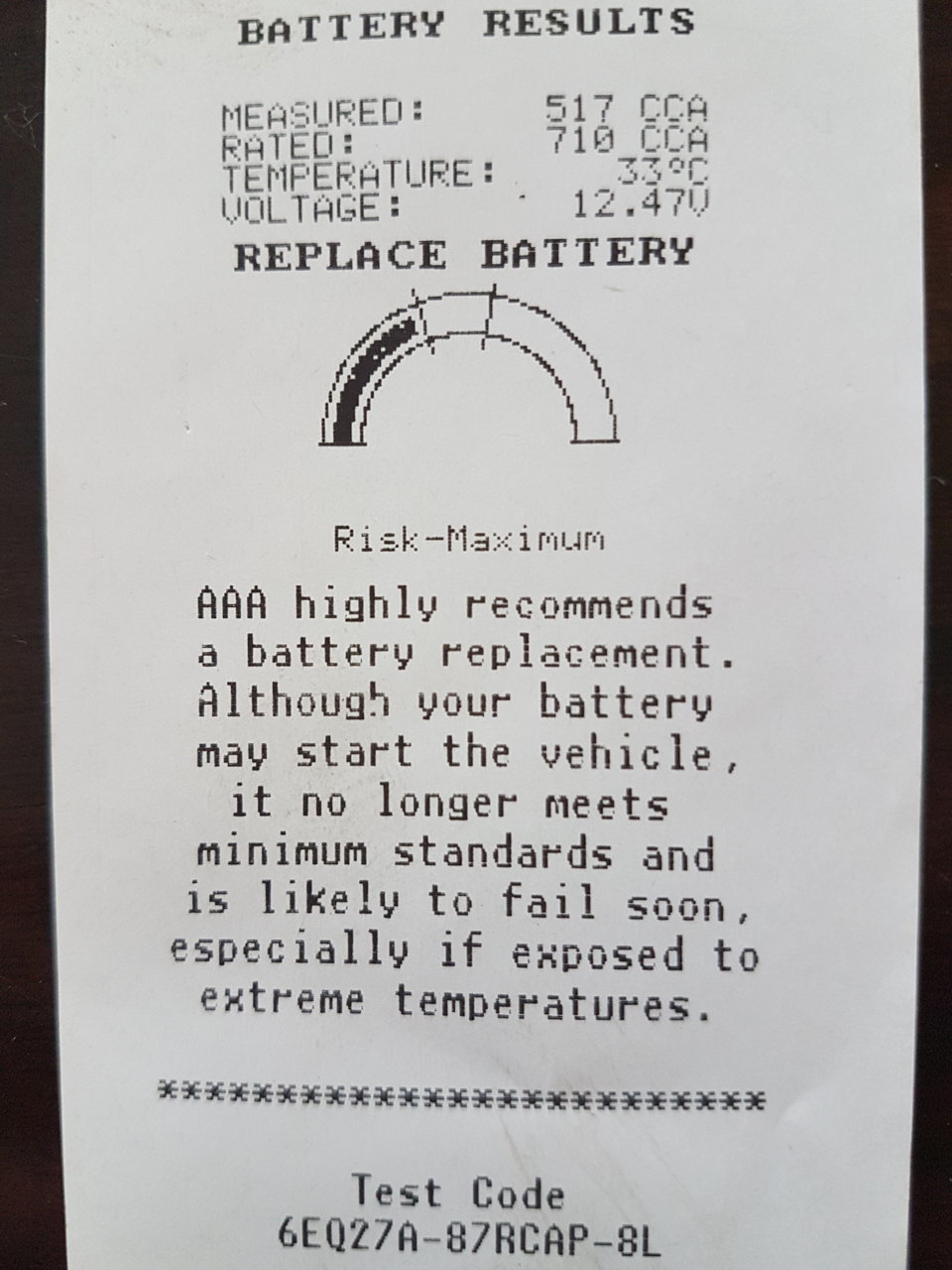

    Have the battery tested first
  11. Jun 24, 2018 at 6:13 PM
    Brudder19
    Brudder19 [OP] Member
    Jun 24, 2018
    #257316
    6
    2010 Blue Tacoma TRD
