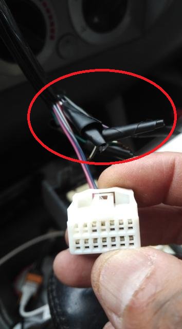

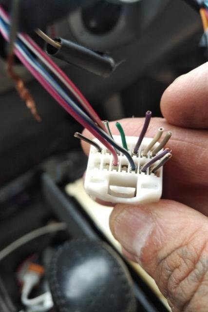

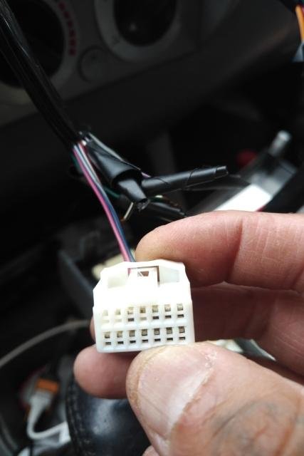

    74DDD0FB-9C84-40FF-860A-6AD87CCC8052.jpg My parents handed me down their 2006 Toyota Tacoma and I’m I’ve been doing some investigating and found that my hazard control/clock wires have been cut off completely (probably from when the previous owners tried to replace the stereo to Bluetooth) and I’ve realized that it’s probably the reason why my speedometer dash lights don’t work at all. So this leads me to my question does anyone know where I can find this particular wire harness for this panel ? I’ve been looking online for a long time and have yet to come up with anything and I was wondering if anyone had any idea where I can find this piece or what I can do to attempt to rewire this myself. Thanks ! It’s 14 pins but some of them are missing the pictures should serve as some reference

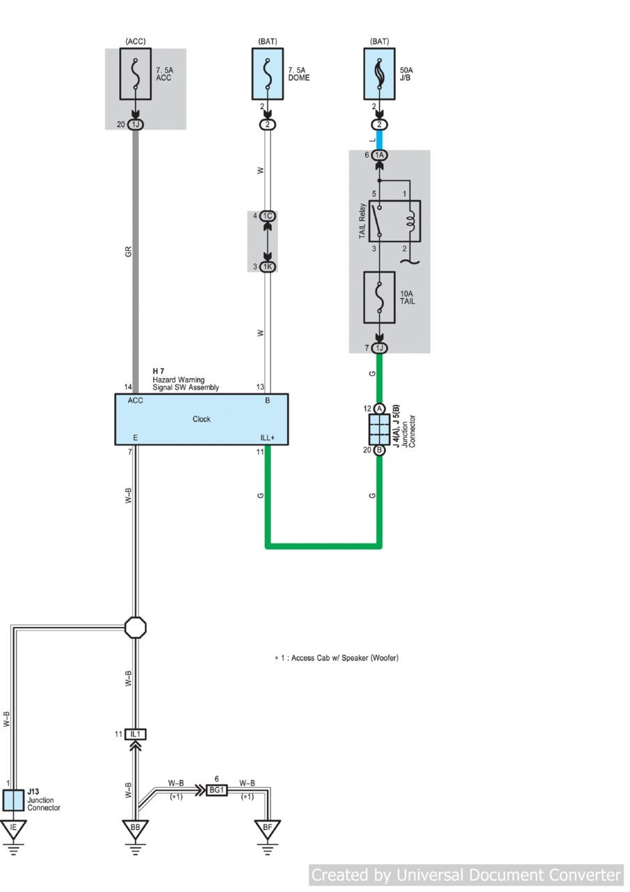

    I hate to reopen an old thread, but I have a question about pins 13 & 14.
    My hazard button bar came without a clock.
    After I verified the clock version also used the same connector, I acquired one.
    Now I come to find out my Tacoma is missing pins 13 & 14 and the clock does not work.
    Since you have been able to identify so much of this, would you be able to tell me what these two provide?
    I'm hoping it's something simple I can wire and route myself, like ground and constant 12V or acc 12V.
    Thanks

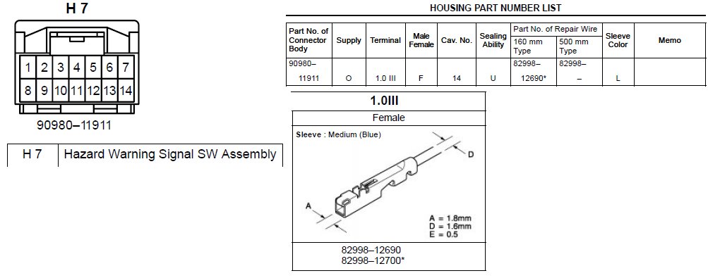

    13 is constant power and 14 is switched accessory power (2014 Diagram).

    #13 is fused battery source (dome circuit)
    #14 is fused accessory source.
