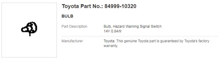

    Thanks for the info. The new part number is 84999-10320 and is a $7 bulb from the dealership. Now that I realize that mine is burnt out I had to order it.

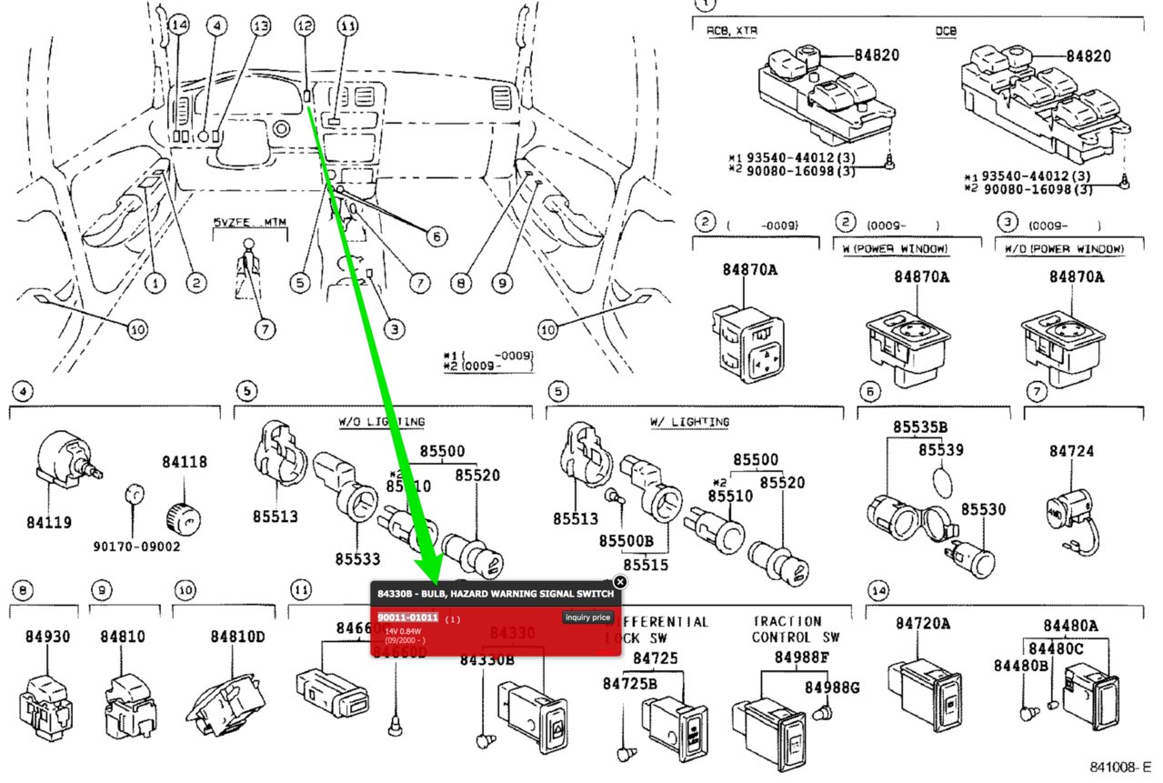

    kinda looks like it should be based on this pic that someone posted a few days ago

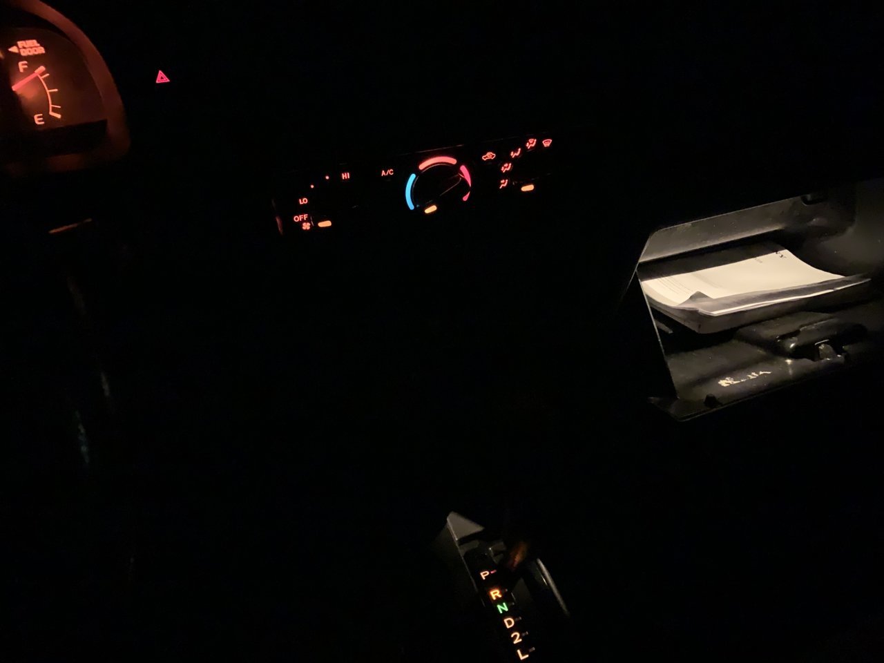

    UPDATE to resolve the question that started this thread: Finally got around to replacing the bulb inside the hazard switch.
    While as was at it, I replaced the bulb in the glove box with part number 90981-11018. It's only a $3 bulb at the dealer, but a bugger to get out. I had to enlist the help of my wife with her smaller fingers to be able to grab the bulb to remove and replace it from the small opening in the roof of the glove box.
    Looking at the lights in the attached picture, I realize that I replaced every one you see. When I got my truck, the shift indicator, glove box and hazard switch were all out. The far right bulb in the cluster was out so I couldn't see my fuel level at night. The far right bulb of the climate control was out so I couldn't see the selector. Since I was in there anyway, I replaced all 4 cluster bulbs and all 3 climate control bulbs so I wouldn't have to do it again anytime soon. So I really only had 5 bulbs in the dash that worked when I got the truck....OK 6, the ECT switch was illuminated, too.
    I removed the cigarette lighter for my subwoofer gain knob location, so I didn't replace the burnt out bulb for it. The only other bulb that I would still need to replace is the one inside the ash tray, but since never open it, I am in no rush to do that.
    It's funny how all the bulbs were burnt out, but then again the truck is almost 20 years old now. Hopefully these bulbs will last as long as I have this truck.

    did the bulb you get, is it a red one?
    i have the awful greenish light hazard and would like to change it to red at some point like in the pic above

    Later 1st gens (2001-2004) have red-orange interior lights like pictured. Your earlier 1st gen has green interior lights.
    Some of the bulbs have a condom that gives the bulb the tint and some of the colors come from the plastic behind the switch/gauge. You'll have to pull yours apart to see what it is and if you can change it. I don't think you can without getting a entire switch from the later 1st gens.

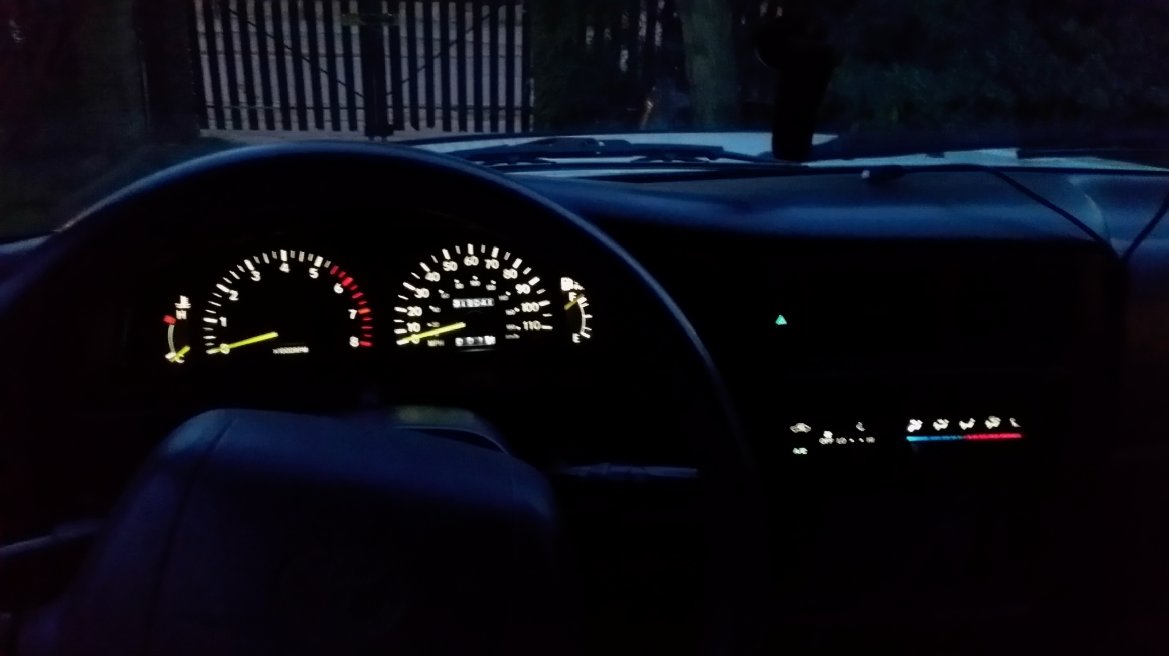

    Here is the dash lighted on my 95 - that little green triangle above the A/C control is hazard lights switch. I have replaced bulb with white LED in there but the switch film coloring made it green (same as it was with incandescent bulb).

  20. Feb 21, 2020 at 7:01 PM
    #20
    ireymon
    ireymon Unknown Member
    Oct 19, 2017
    #233460
    687
    Kenneth
    Winston-Salem, NC
    99 X-Cab 5 lug 5 speed
    Hyundai wheels, dings & dents...
    Well would ya look at that!
    jammer likes this.
