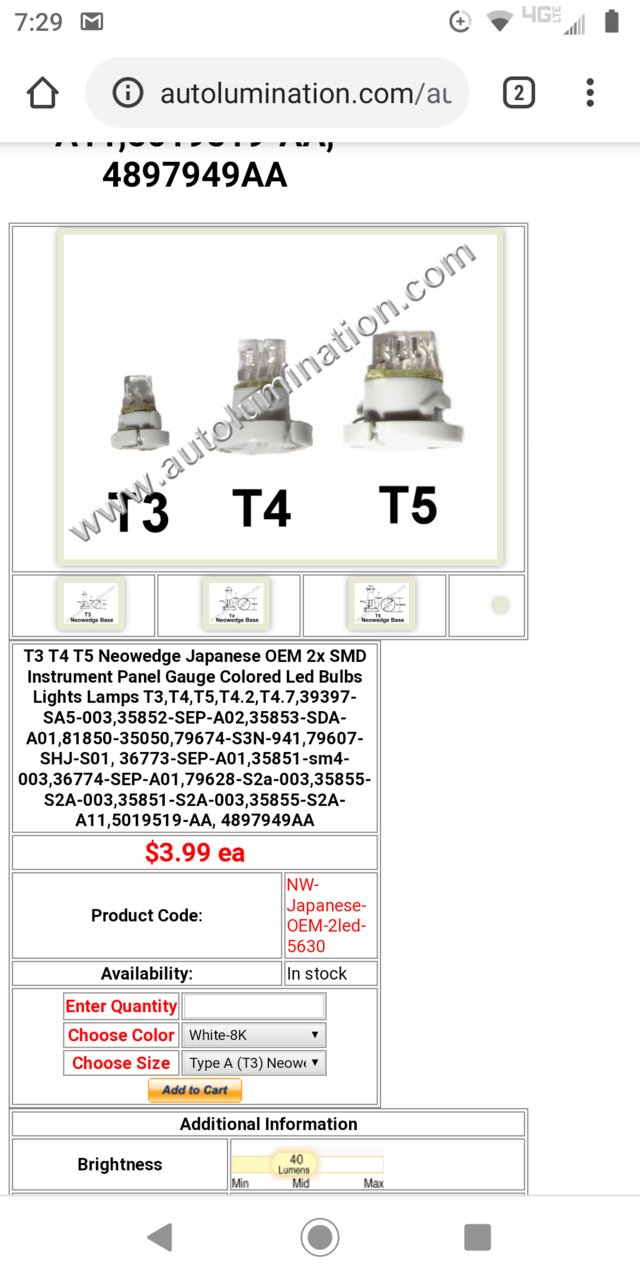

    Sorry for the late response. I'm away from my stuff at this moment and I can't check if it was T4 or T3 - I think it is the smaller one but I can be wrong.
    But one thing I do remember - most of these LED bulbs don't work out of the box. Most of T4 and T3 bulbs have LED projecting in one direction (perpendicular to the base). Because the bulb is installed in the switch from the side it needs to project light parallel to the base (towards the front of the switch). Most T4 and T3 bulbs will emit zero light into that direction meaning the lighting of the switch will be marginal.
    To solve the problem I actually modified a LED bulb by resoldering LED chip to point it into right direction. PITA but doable. I will have some pictures later.

    Ive got these for my climate control. Fixes that issue.
