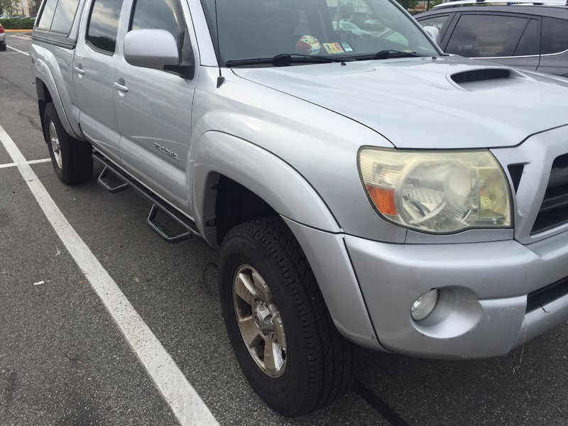

    The headlights on my 2006 are pretty hazy. Any suggestions for replacing them or having them fixed? I'm willing to upgrade to something better like LED but not sure where to start. Is this work I can do myself (not terribly handy).
