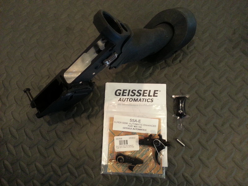

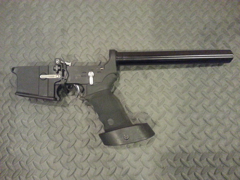

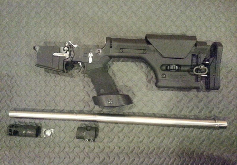

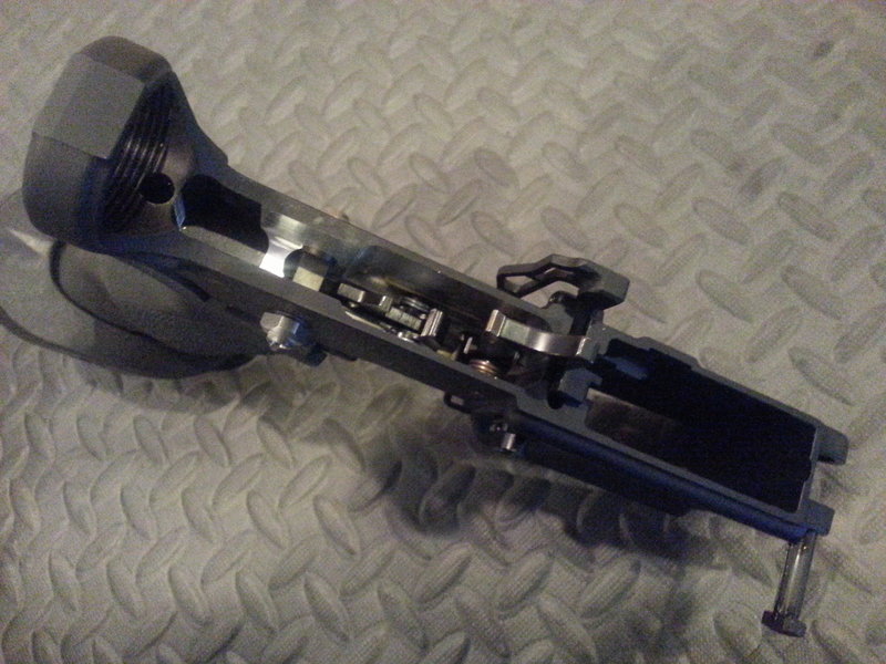

    Geissele SSA-E super semi-automatic enhanced, small pin, two stage trigger group, PN #05-160.
    This trigger group is designed for target/precision shooting and has a 2.3lb 1st stage and a light 1.2lb 2nd stage! ;)

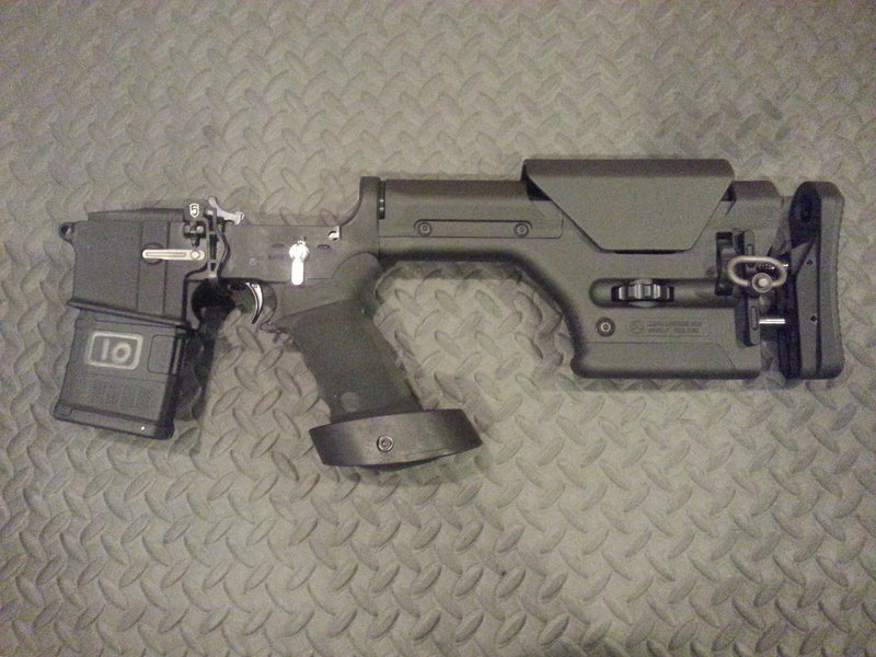

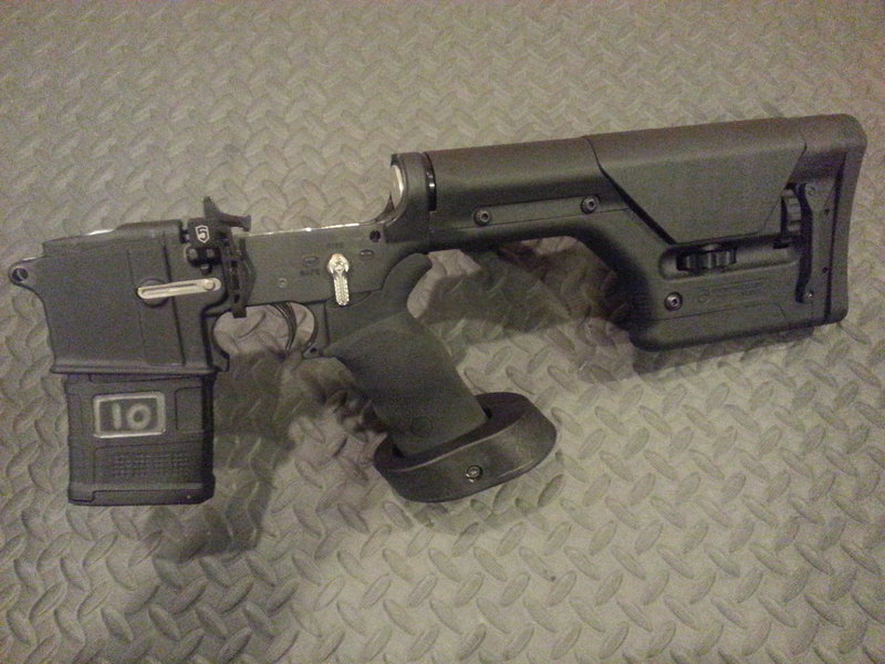

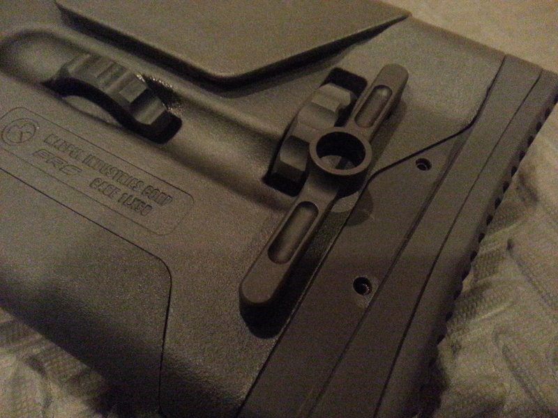

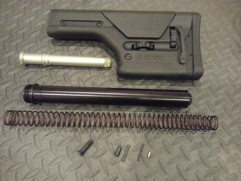

    Magpul PRS sniper butt stock, Damage Industries rifle length buffer tube, buffer & enhanced recoil spring. :)

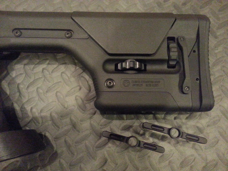

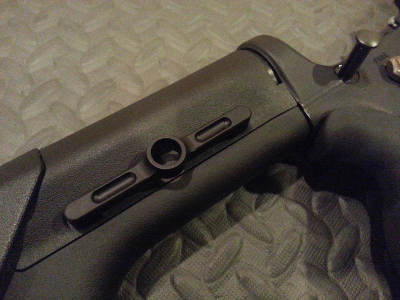

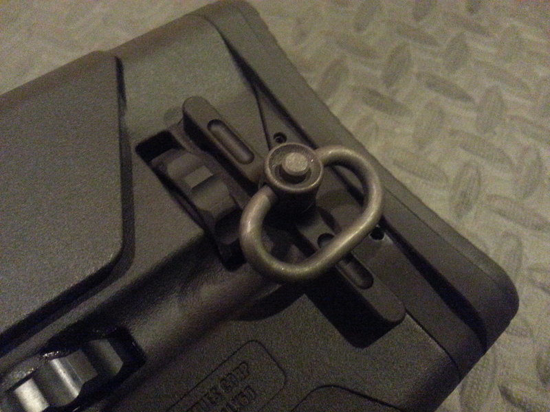

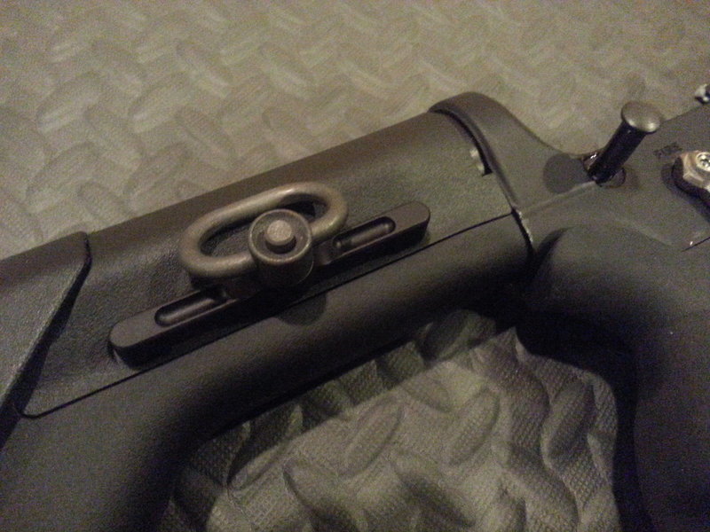

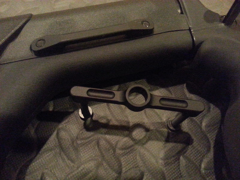

    Parker Mountain Machine QD sling mounts replace the foot man's loops on each side of the PRS stock. :)

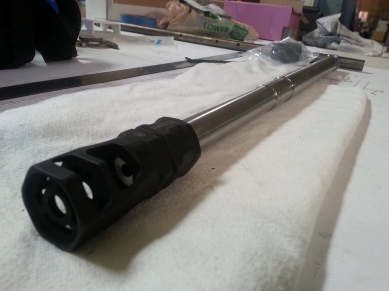

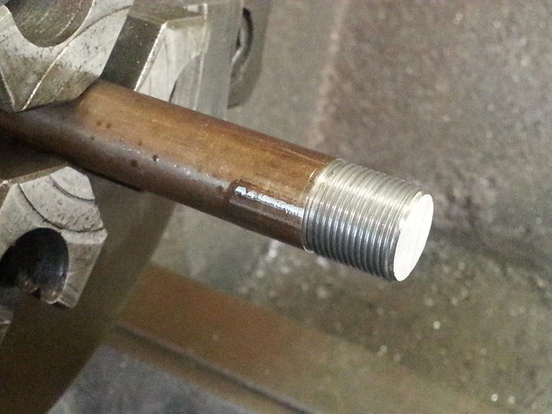

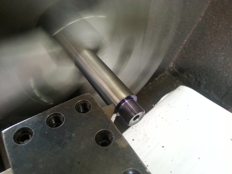

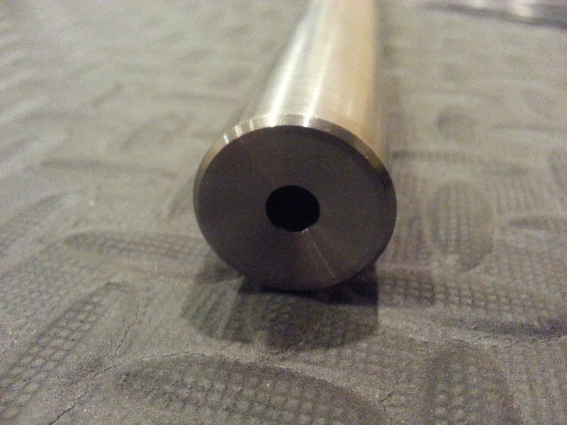

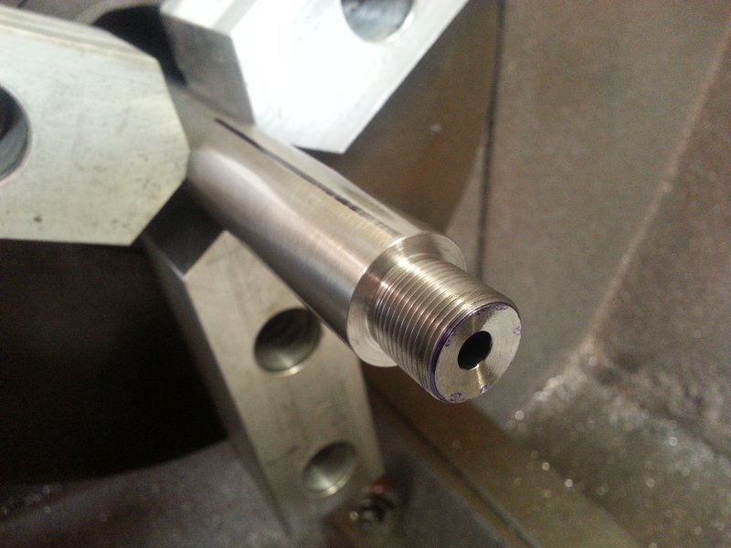

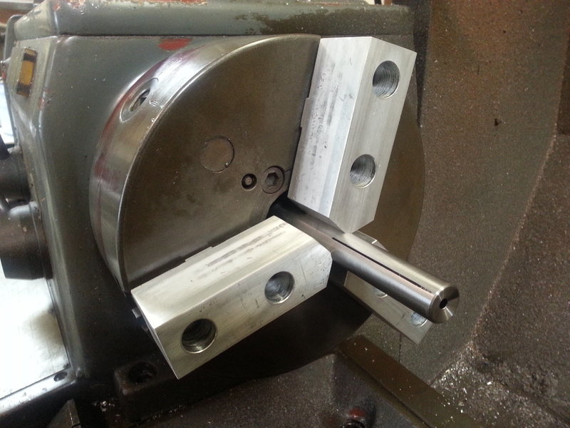

    White Oak Armament 22" heavy varmint barrel, stainless steel, chambered .223/5.56, 1-8 twist, came with gas block, first barrel section out of upper receiver is 12" long and diameter is 1.0", gas block section is 2.0" long and diameter is 0.939", muzzle section is 7.0"long and diameter is 0.855", barrel weight is 4.09LBS, does not come with threaded muzzle, comes with 11 degree crown.

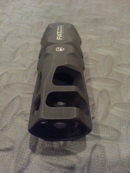

    We are going to thread the muzzle tomorrow with 5/8"x24 threads, about 0.650" long to accommodate the Phase 5 FATman brake. I will put up some photos of the threading process!!

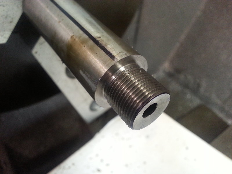

    OK, made a test run! Then worked up the courage to give it a go!!!
    IronPeak likes this.
  12. Jul 16, 2016 at 1:40 PM
    #112
    HBGIBBY
    HBGIBBY [OP] Well-Known Member
    Aug 18, 2015
    #162146
    1,894
    Ian
    Huntington Beach CA
    2011 DCLB 4x4
    No Mods Yet

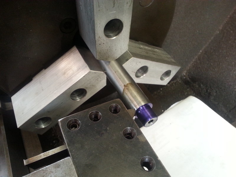

    Very nervous. ...
  13. Jul 16, 2016 at 1:44 PM
    #113
    HBGIBBY
    Aug 18, 2015
    #162146
    1,894
    Ian
    Huntington Beach CA
    2011 DCLB 4x4
    No Mods Yet
    Next step....
  14. Jul 16, 2016 at 1:45 PM
    #114
    HBGIBBY
    Aug 18, 2015
    #162146
    1,894
    Ian
    Huntington Beach CA
    2011 DCLB 4x4
    No Mods Yet

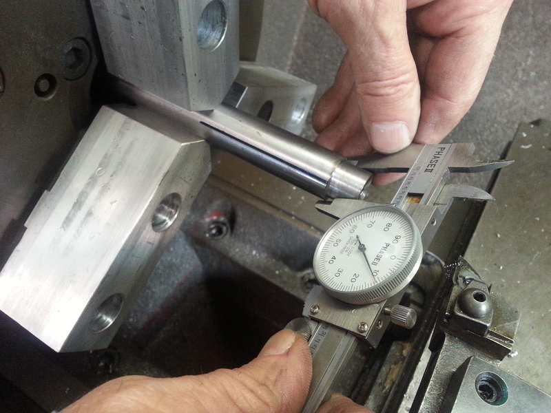

    getting close....just a few more passes on the threads and cut the reveal....
  15. Jul 16, 2016 at 1:46 PM
    #115
    HBGIBBY
    Aug 18, 2015
    #162146
    1,894
    Ian
    Huntington Beach CA
    2011 DCLB 4x4
    No Mods Yet
    All done! :)

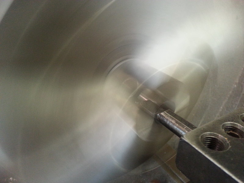

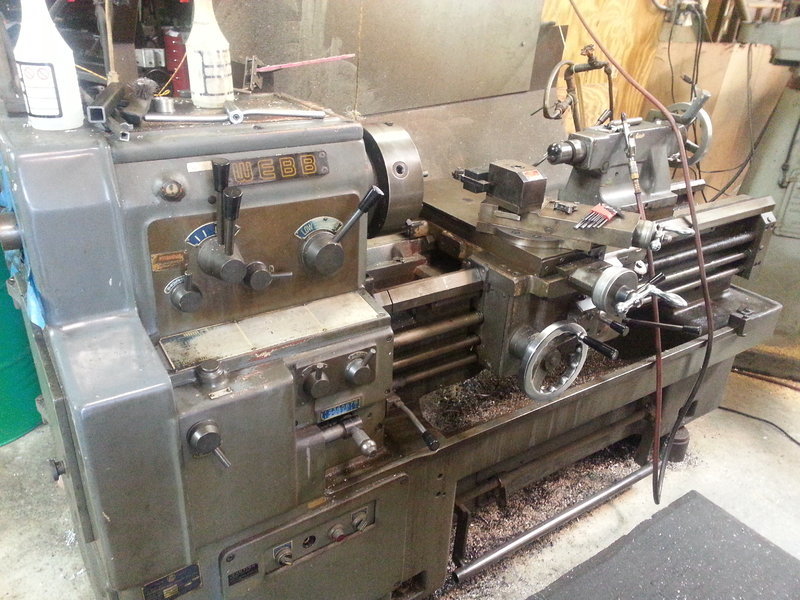

    Thought this was a cool photo, the jaws are spinning so fast you can see right through to the cutting tool inside, cutting out the hole to hold the barrel in the lathe. .. :)
