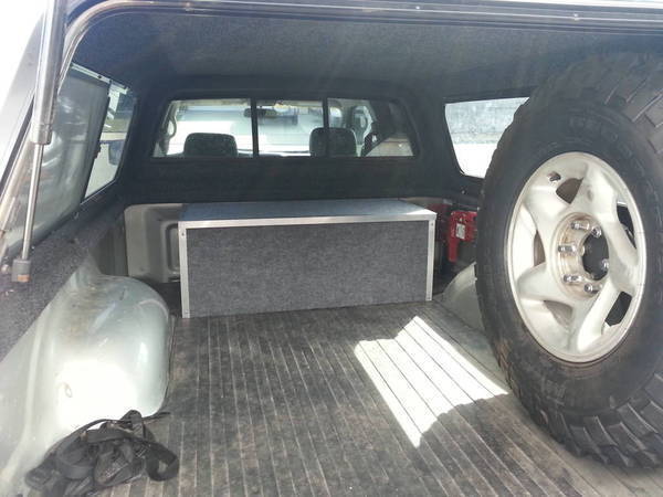

    Built a storage box for my bed. Used materials I had laying around.

    Those storage bins look pretty nice. Way more useful than the "seats".

    Thanks. Its nice to have my gear inside the cab.... I dont need more than one passenger while going off road....
