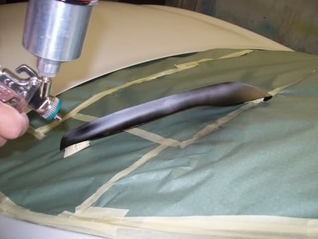

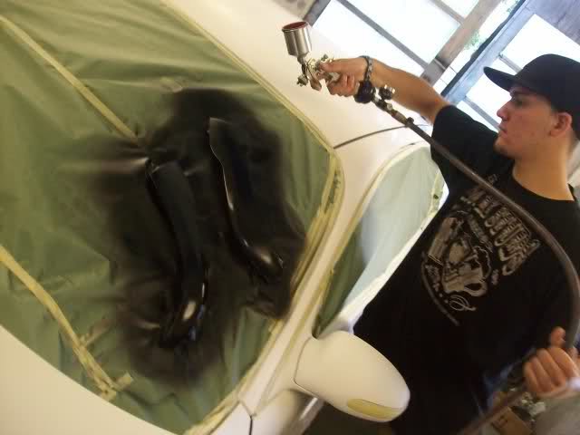

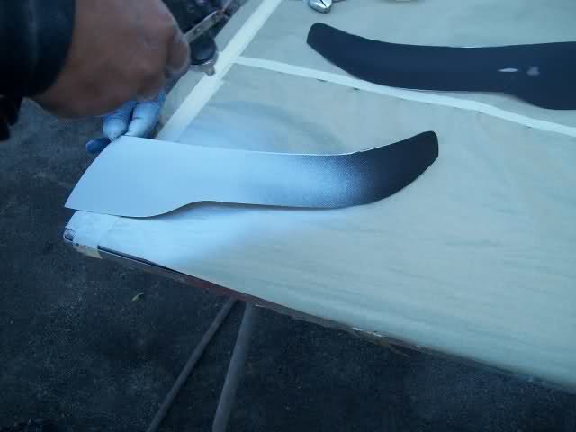

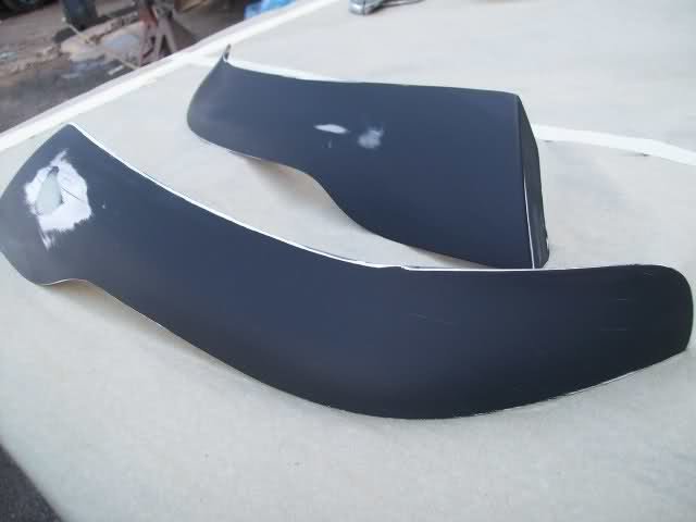

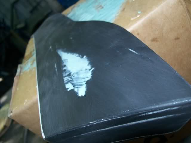

    :Di just recieved my T Rex eyelids n finished painting em with my dad, took some pics and thought id share wit you guys...
    when i recieved the eye lids i was shocked at how poor the quality was. the edges were uneven and not sanded right and the eyelids had some cracks in them. i used duponts flexible putty to fill in the cracks on both sides, Then sanded. after we shot it with a few coast of primer we then wet sanded with 300 to get the texture out and then hit it with 600 to smooth the inperfections. then it was ready for paint! In the end they came out perfect! :D

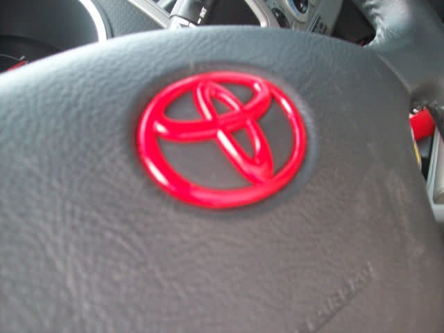

    Ray painted his steering wheel emblem, he removed the emblem carefully with a tiny screw driver, sanded it, and painted it rad red.
    im going with a Black, Silver n RED theme now:D
    i can only wish:rolleyes: lol took rays toyota emblem, this is what i will be dong once i get my hands on one
