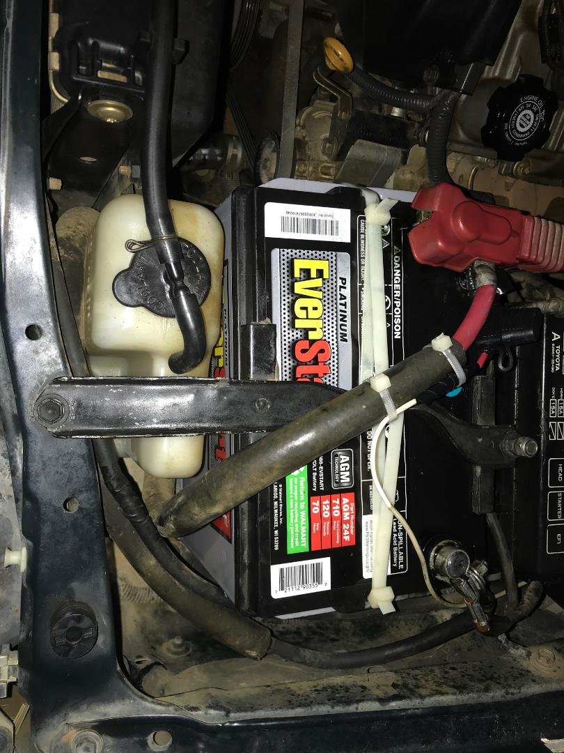

    I do appreciate the input. Just not sure the poly construction trays made by East Penn/Deka/Lynx or Attwood will take the beating my Taco mud truck gets. Would rather go with a battery size specific steel tray, preferably coasted to resist all the deep mud/high water this Taco sees. A stainless tray would be ideal for my use but all I see is the low quality made-in-China SS trays. Still kicking this upgrade around in my head.
    The (2) opposing super-sized zip ties secure the 24F AGM battery from sliding around with the OEM battery mount bracket attachment. This works but a solid battery tray mount would be a better solution especially if I upgrade to the larger/heavier/much more capable 67 lb. Northstar X2 27F battery IMO.
