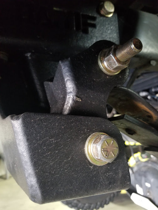

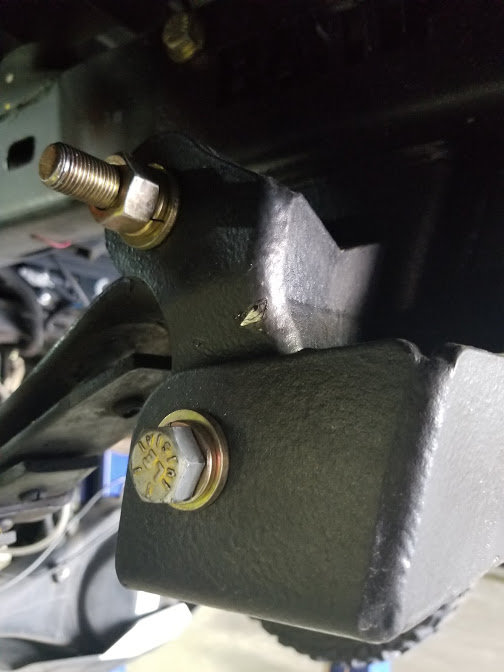

    day 2 after install on all pro expo springs

    Looks like some contact. Is this after stuffing your rear tires? What rear shock setup do you have? I have the expos too but haven’t installed the hangars/shackles yet.

    this is not at stuff, its at normal riding height

    I mean when the contact on the shackle occurred

    yeah the contact is from normal ride height. The photos are posted with the truck on a lift
