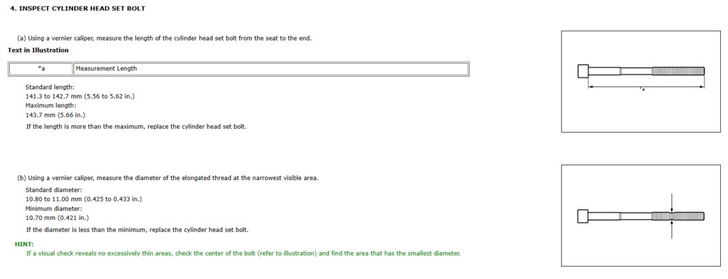

    ^FSM shows they're re-usable, so not torque to yield

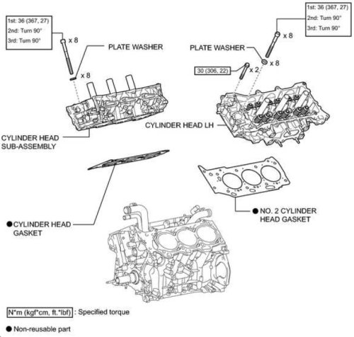

    Yes they are TTY (27 ft-lbs + 90 degrees + 90 degrees), FSM states they can be re-used if they meet specs.
