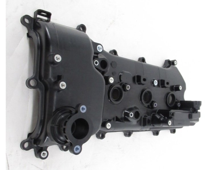

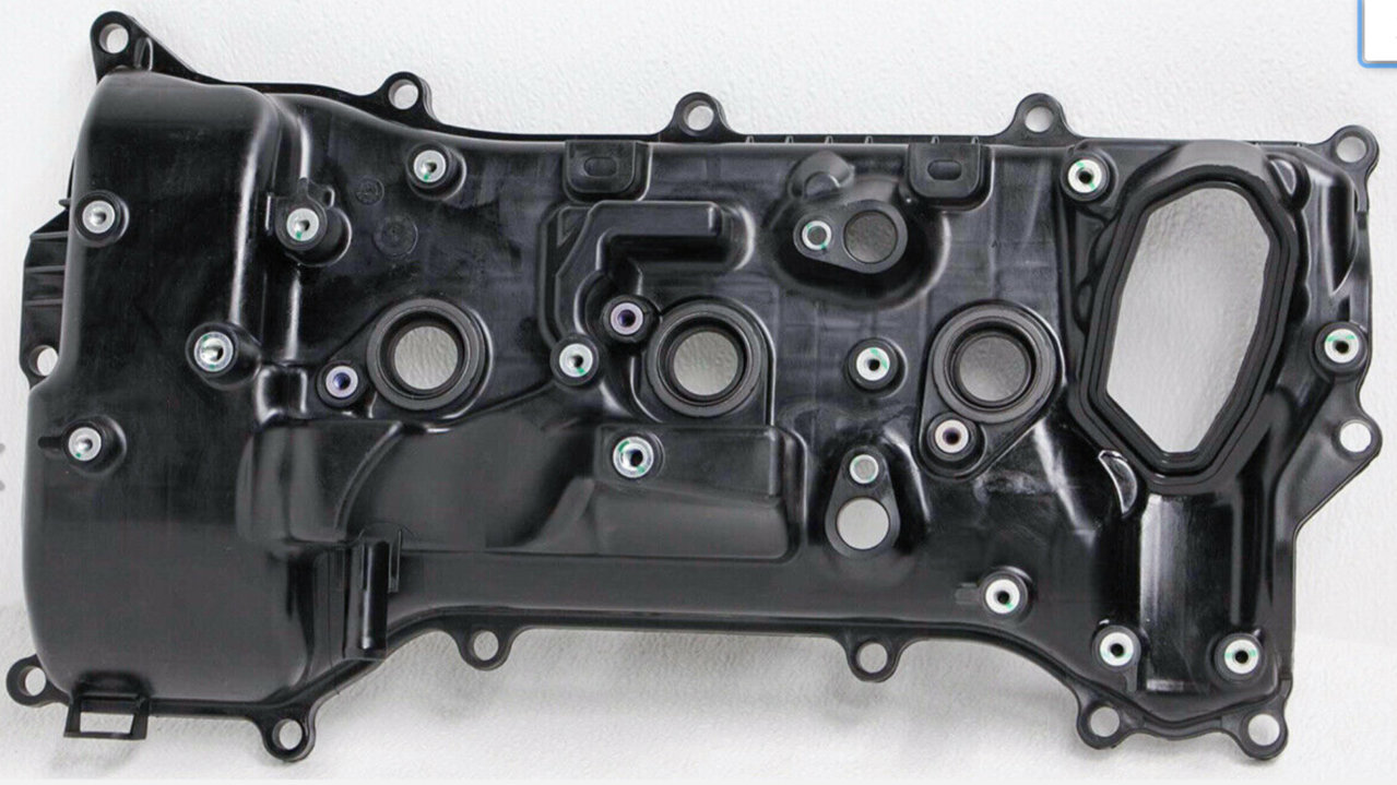

    That’s nuts! A new engine is only 13K.
    Driver is Left, Passenger is Right.
    Valve Cover (LEFT) - Toyota (11202-0P032) ~$250
    Valve Cover (RIGHT) - Toyota (11201-0P010) ~$250
    i don’t see what they are referring to in either of the pictures (either side).

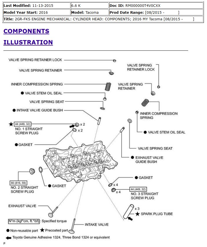

    An oil check valve in the head would most likely be there to prevent oil drain down. It would be inline with the Oil Passage and internal.
    They diagnosis that they gave you sounds bogus.

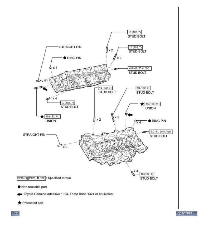

    Looking at an unassembled valve cover will probably not be useful for identifying a component that is part of the head.
    The FSM goes into teardown/rebuild of the heads as far as all of the typical stuff like valve, guides, seats, studs and also includes press fit pins and the spark plug tubes but it doesn't mention anything about a check valve or any valve that is pressed into the head.

    I either read or misunderstood it to be something pressed into the cover. Agree, cover won’t reflect what is in the head. However, why would a head leak oil externally? Venting and flow is typically to cover.

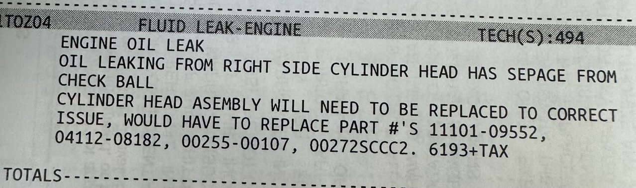

    I took it back in yesterday for diagnosis, and the Dealer/Mechanic gave me the following diagnosis (in-line with your issues above):
    "Oil leaking from right side cylinder head has seepage from check ball. cylinder head assembly would have to be replaced." and they verbally told me I was in the $7K range for parts alone...

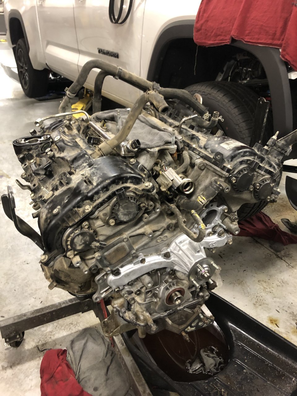

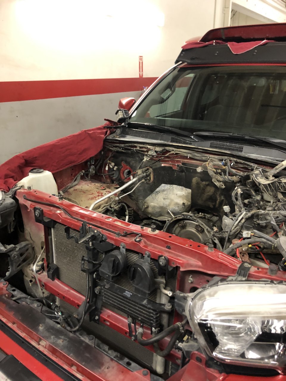

    I had the same issue. A buddy of mine works at a Toyota dealer as a service writer and he went to town with my third party warranty company to try and get them to pay for it(also estimated at $11k) but they fought pretty hard against it and declined so the shop foreman tried to jb weld it as best as they could and put it back together.
    2016 and 2017 have this early version of the head which is shared with other models that use this port however on the tacoma its just plugged with a press fitting that with enough heat cycles will start to leak. Starting in 2018 they dont have that specific issue anymore. Thats what my buddy said anyway.
    Unfortunately I can’t find or didn’t save the photos from the little scope camera so here’s photos of it sitting at Toyota while the great warranty debate was happening lol.

    The Service desk told me that one of Toyotas top mechanics looked at my truck and has seen this issue before. When he saw the leak, he immediately knew this cylinder head has seepage from the check ball.
    They cannot provide pictures without a “tear-down”. I attached a picture looking from the right wheel, just past and behind the alternator you can see the oil coloring. Based on this view, the mechanical knew it was the check ball in the cylinder head. Yet this can be confirmed without a tear down. Catch 22.

    Also here is the “report”.
