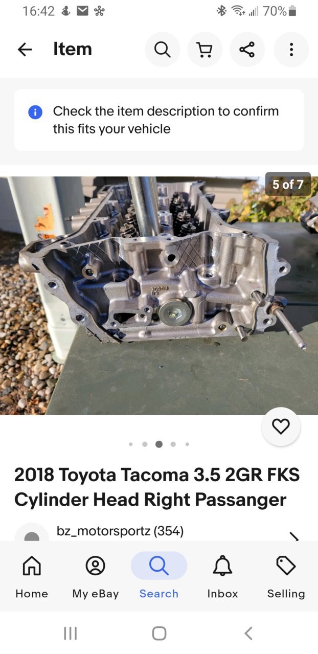

    Here us the image from eBay. That thing on the left upper side could be the "check ball".
    But, it is behind the cover. Even it has a seepage, the oil should not appear outside of the engine.
    Check the timing chain tensioner cover, small square to the right of the ps pump

    Is this 3.5 V6 engine?

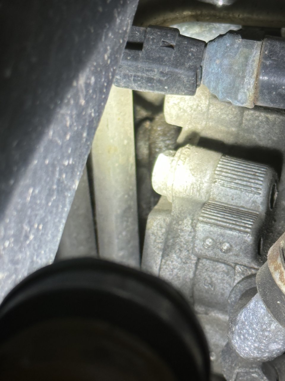

    I know this thread is a bit old but it’s the only thing I can find on the Cylinder Check Ball Oil Leak. I have a 2017 Tacoma 150,000 miles dealership has resealed my Timing Cover 3 times. 2 under warranty and 1 time no charge after I called Toyota HQ. It’s now been leaking again for past 6 months, about a 1/4-1/2 quart every oil change. Today I pulled the Power Stearing pump to see if I could locate the spot and seal from outside. Was hard to tell exactly where it was coming from but I discovered the Ball Check Valve behind the pump. Couldn’t tell if that was the source of the leak but now I’m wondering if it was that all along. Cyclinders seem fine, when I had the timing cover sealed the 3rd time in Dec of 2023 the service manger mentioned something about checking the cyclinder but then told me it was indeed the timing cover again.
    Anyway was wondering if anyone has got any more info on this Check Ball Valve thing?

    Looks dry to me , doubt that’s where it’s leaking

    FYI - This is an oil gallery plug. They are using a steel ball to plug a hole. It is not a check ball or check valve because the ball does not move. It’s just a plug.
    That being said, I -suppose- it’s possible for it to develop a leak, but I think that would be extremely rare. In the photo, everything has an even coloring. I don’t see the ball as the ‘source’ of any leak.
    As for the oil loss, most likely culprits are gasket leak or burning oil. Is there an area of the engine that is oily to the touch, or is dripping oil on the floor? Anyone else have opinions/experience about oil burn for an engine with 150k miles?

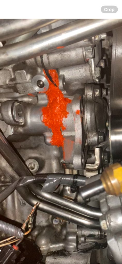

    My leak turned out to be the timing cover again, not the galley plug. Here’s how I fixed it. Took me an hour and $10 vs 20 hours and $5,000 at the dealership. I’m not a mechanic, just a fella fed up with this leak. It’s ugly but 10k miles later and still dry! Not sure why the galley plug couldn’t be sealed from the outside also?

    I used permatex high temp, but what you have there will work. You don’t even need to pull the lines off the power steering pump unless you want to change the fluid. Just remove the 2 mounting bolts and swing the pump toward the front of engine. After I cleaned it up, I couldn’t really tell where it was leaking from, assuming somewhere near the galley plug where the cover and top of block meet. I probably used way more permatex then needed. Funny story, just took my mom to the dealership to buy a Rav 4, salesman says how do you like your Tacoma, he has a 2021. I showed him my fix and told him they tried to seal 3 times and failed(different dealership) he said he’s never heard of the issue…yea ok!
