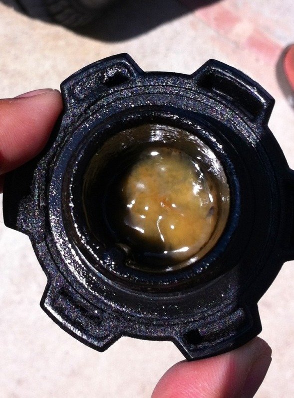

    thanks pho, I will look into that..
    by the way, here's a pic of my nasty oil cap:
