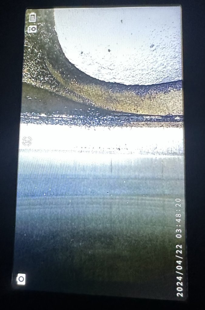

    Sorry for the poor photo. It’s been under pressure test pretty much all day and I can see what looks like micro droplets on the cylinder walls? This is the only cylinder that looks like this too @slater

    Only thing I can think of, you caught it so early its minimal & hard to replicate, but again, the mist of water entering the cylinder still, again....
