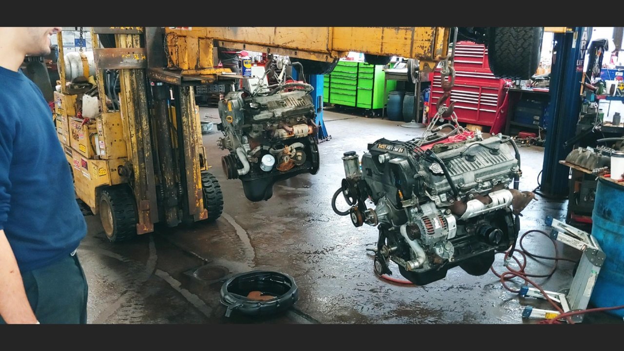

    I was on the fence weather to rebuild or replace my poorly maintained 200k+ head gasket failure when I first bought my taco and just only did the gaskets.... Fast forward 15k down the road and I lost a piston to the infamous "5vz death rattle" failure... Went the under 60k JDM route (JDM Arlington $1200 shipped) after-all and tossed good money into bad on a destined-for-failure engine... If it went around 200k then it was probably maintained like mine and plausibly have a catastrophic failure down the road as mine did. Just food for thought...

    Sorry to hear about the trouble. Did the "death rattle" and piston loss start with a bad wrist pin? I've seen a couple of noisy wrist pins on here result in engine replacements.

    YES! Freaking #6 wrist pin...
    The little Spanish landscaper I pulled over and talked into the McDonald's parking lot (I pulled a "Counting Cars" on him) and talked him into selling me his CLAPPED-OUT work truck, never did a lick of maintenance in almost 125,000 miles of ownership. My Spanglish is just enough to get me through a conversation with my non-English speaking customers but, from what I interpreted, the little guy changed the oil about 4 times in 8 years of ownership. 30,000 mile oil changes???? You bet ya!!!! I took on that responsibility as I paid him what the truck was worth ($3000) and my shop had 7 lifts at my disposal and this thing needed $4000-$5000 worth of work. But it was going to be my daily and didn't mind the idea of just rebuilding EVERYTHING and having a virtually new, reliable 1st Gen for hundreds of thousands of care-free miles.
    Now....It started as a barely noticeable tick when idling next to a building and you can hear the echo... Kinda like if you go over an oil change 1000 mi. or so and things start to get a little noisy. Within 2 months It developed into a "lifter tick" tapping sound that would stay there around 1100 rpm's as the truck was warming up and the idle is naturally going down to 700 rpm's or so... By the end of summer it developed into a solid tick from 1100-2000 Rpm's (hot or cold) but would go away under a load or after 2000 rpm's.. At cruising speed, no load, around town, it sounded like someone smacking the block w/ a hammer.. Time to call TX jdm.....:censored:

    Thanks for the detailed response. The symptoms sound exactly like mine. I bought mine for cheap with the "death rattle" knowing it might turn into an engine swap. I found a 70,000 mile engine from a rear ended 4Runner at LKQ that I could verify the mileage and service history. I changed all of the old rubber seals/hoses and did my own swap. It was expensive at the time, but its like driving a new truck now. I still have the engine in the garage that I want to tear down to find the tapping cylinder. It sounded like it was at the rear -- possibly #5 or #6 as well. I know of two other members that have done engine swaps over the "death rattle". I am starting to see a pattern that comes from neglect of oil, cooling system care, or both.
