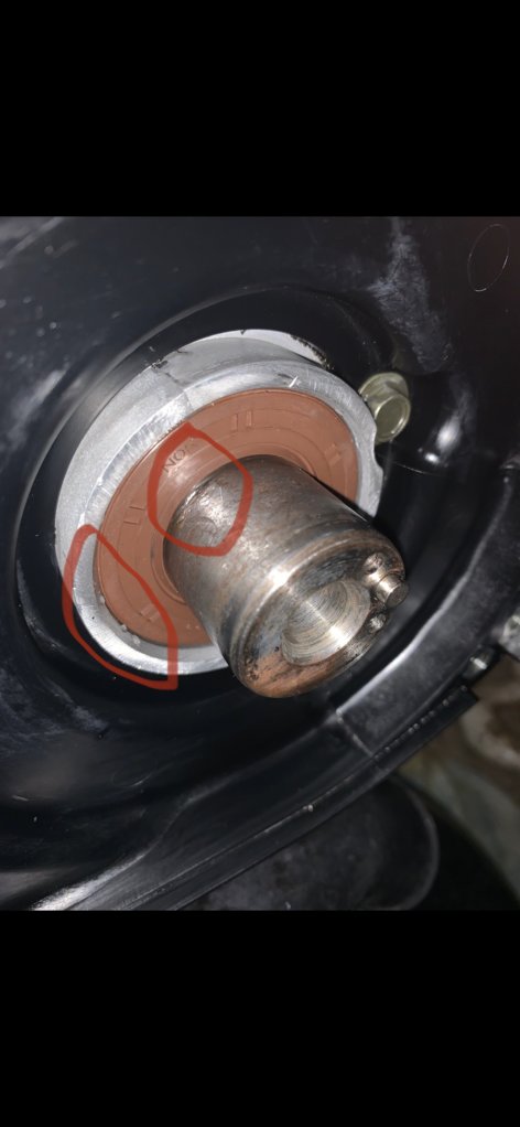

    Bc you said L “wheel/caliper”
    I’m going with L head cam seal(s)
    remember
    The cooling fan and motion of vehicle will spray that crap oil everywhere

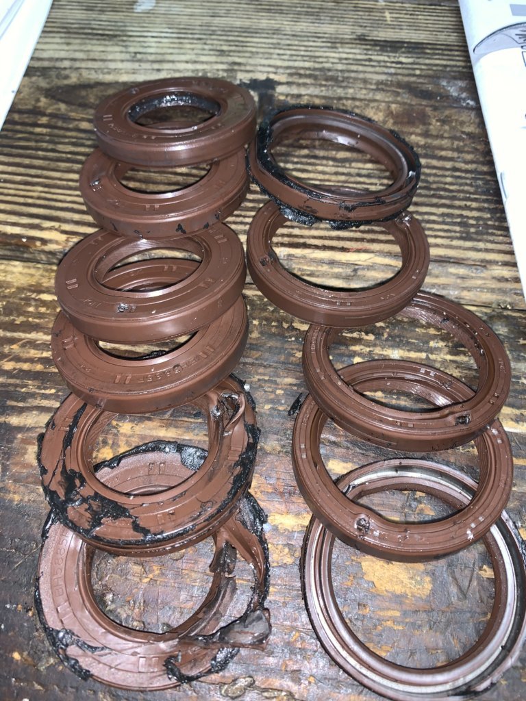

    Best way to locate general “area “ of this seepage is to blow $16 on several cans of your favorite degreaser/brake clean
    Power wash the L side of engine
    Then monitor
    u will see the general area then focus in on that area….do this b4 starts coating wheel/caliper
    That’s how I found my cam seal leak on my Forester. Totally clean from pressure washing, then saw pretty big/fresh drips from behind plastic TBelt cover on L side

    PM me if u need great tech tips on cam seal removal!
    That was 1st 3 attempts searching for oil leak…..dipstick Mechanic forgot to RTV cam carriers
