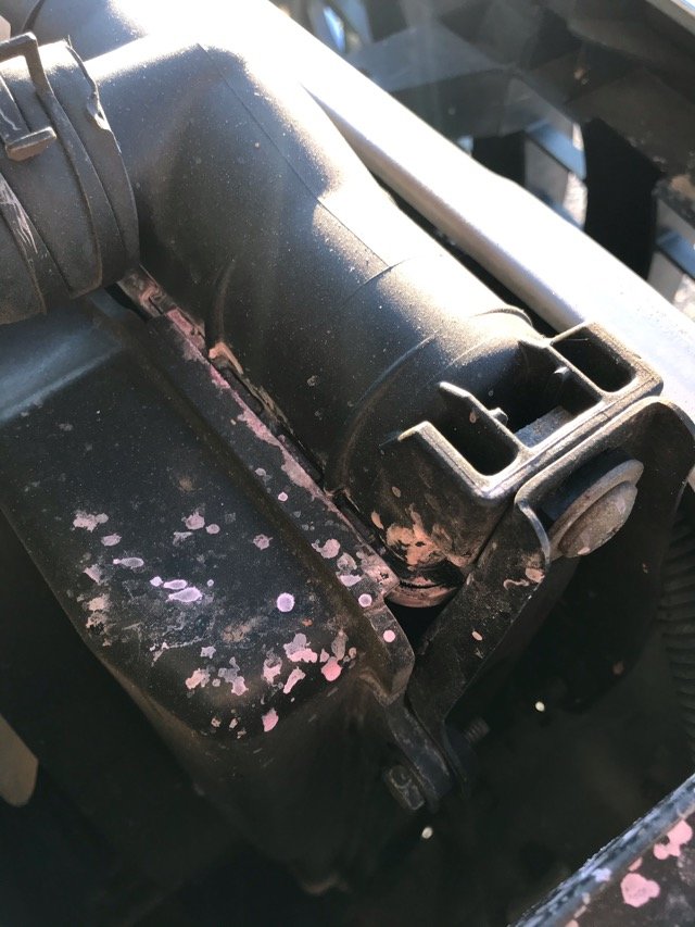

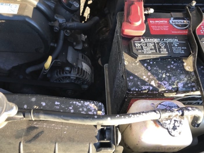

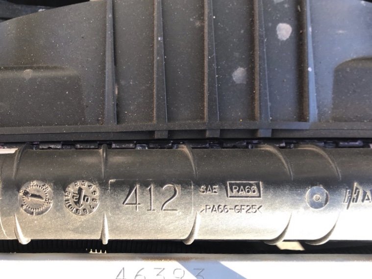

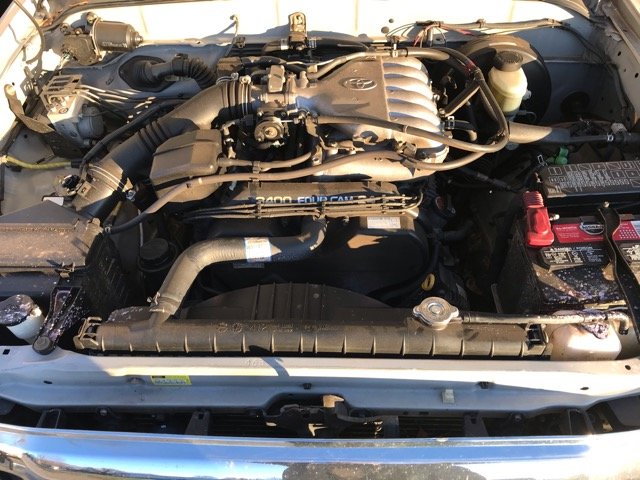

    I bought this truck back in July, it currently has 194,550 miles on it. Haven't had any problems with it until a couple weeks ago. Antifreeze starting coming out both sides of the radiator where the plastic meets the aluminum. It doesn't lose a lot of antifreeze at all, you can smell it and see it though.
    I replaced the radiator cap hoping it was bad not letting off pressure but that didn't help.
    The heater blows hot as fire so I know it's not stopped up.
    I've checked the oil and it's clean as can be so no antifreeze getting in there.
    Could this be a blown head gasket putting pressure into the cooling system and it's coming out at the weakest point at the radiator or is it just time for a new radiator?
    I hate to put a new radiator in it and mess it up if it's a head gasket.

    My vote would be radiator. They're known for leaking around those spots with some age to them.

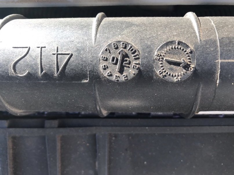

    I hope that’s the case. Just went and looked and this one appears to be the original manufactured 9/02. Looked when the truck manufacture date is and it’s 10/02.

    When my water pump went it spattered droplets like that flung by the fan.
    Check the bottom of the housing for drips.
    If you can't see, wash everything off, run a little, drive a little and check often to see if you can find another source.

    One check for a blown head gasket is to run the engine with the radiator cap off and look for bubbles there....

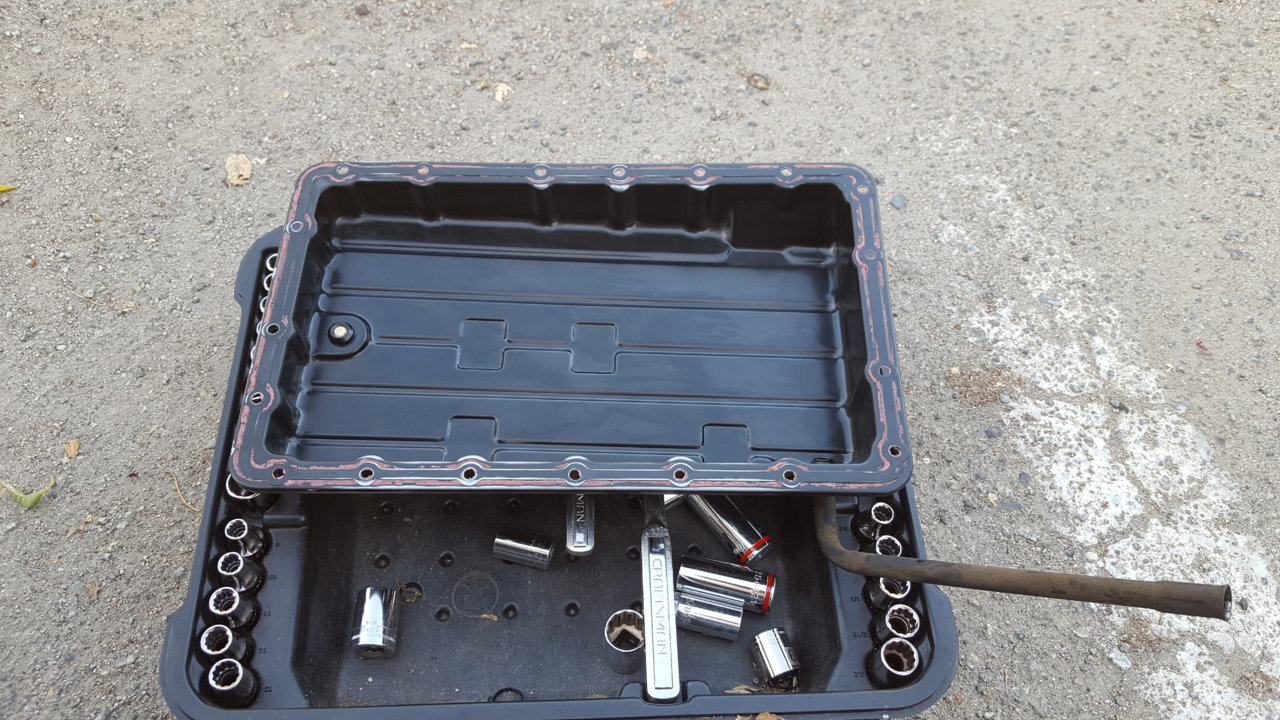

    Something else to think about is adding a transmission cooler while you're in there if your truck is an auto.
    I beat on my truck and it's at 244K miles so I'm thinking I might replace the radiator before it starts to leak and add a transmission cooler while I'm in there. My transmission hits 240 degrees pretty often.

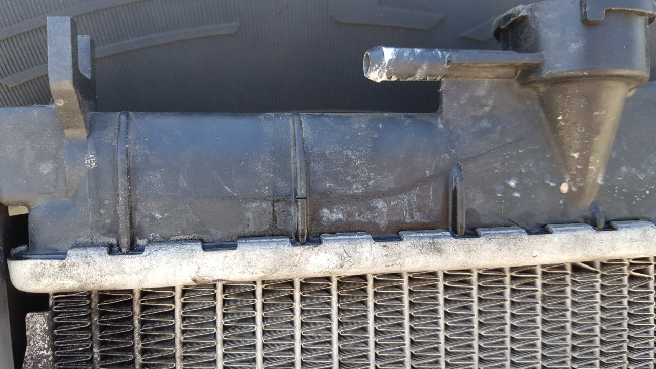

    The hairline crack I had in my radiator when I replaced it -

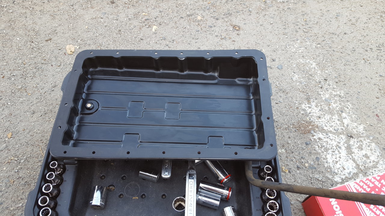

    If you've got a day, buy about 7-8 quarts of transmission fluid, a transmission oil pan gasket (count the bolts on your pan and get the right one), brake cleaner, a few rags, and a scraper tool so you can completely replace your transmission fluid as well -
    The scraper tool will allow you to easily remove the gasket maker used on the pan and transmission.
    Misc. rags will allow you to wipe up dirt and grime on the mating surfaces that should be clean when you reinstall the pan. You can also use them to clean the magnets inside the pan.
    The brake cleaner will aid in the cleaning of the pan itself, as well as the cleaning of the transmission filter -
    Having a supervisor around will keep you on your toes and keep you from lolligagging -
    245k miles and the pan has never been removed -
    Some elbow grease to clean it all up -
    We wouldn't suggest you to do anything we wouldn't or haven't done ourselves.

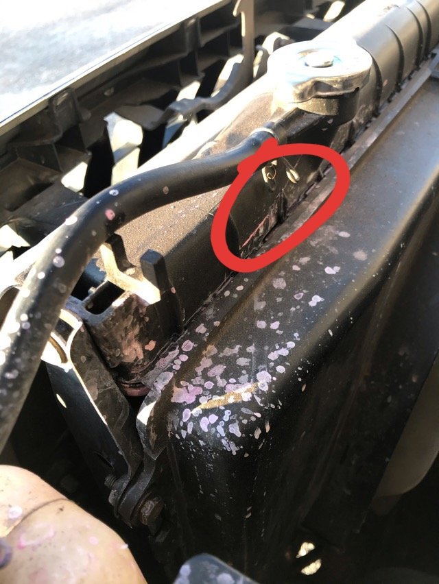

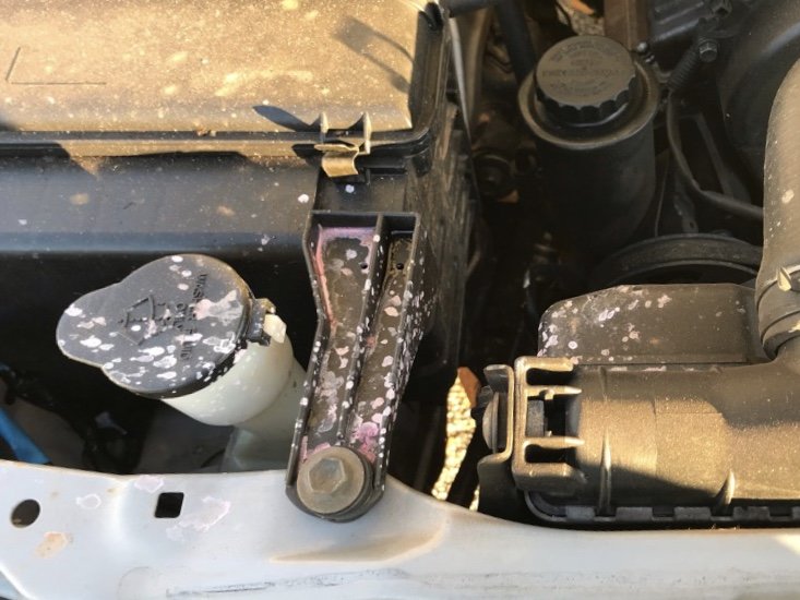

    Oh and isn't this one of the cracks on your radiator?
    Was only able to spot mine after I removed it but yours looks pretty clear -
    six5crèéd[OP] likes this.

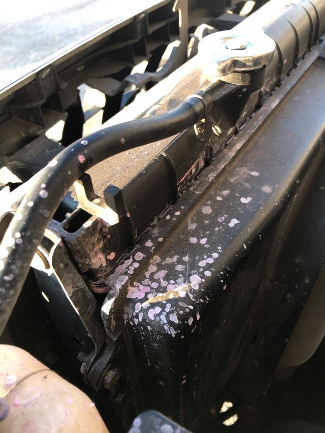

    Sure is, I went out and looked and it's on both sides of the fill valve. Can't see the one on the opposite end but it's leaking just as bad.
  16. Dec 5, 2019 at 9:03 AM
    #16
    Kwikvette
    Feb 27, 2019
    #284735
    82,032
    Fresno County
    4 run, 2 don't
    Well had I looked at all your pics, that would've been a 5 second diagnostic lol posting from a cell phone.
    Anyway, it's an easy job.
