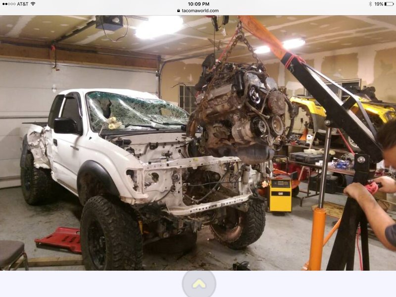

    image.jpg Ok, thanks for all the advice, here's my update.
    Look what I found!!!!!
    Glad I waited,
    I found a local person that rolled his truck on this site with a low mileage engine a little over 100,000 very clean out of an 2004 Tacoma that is being taken out now.
    Here's the photo from the donor trunk and engine
    I'm so excited to get it running again and yea, won't have to worry about those heads or any oil leaks anymore.

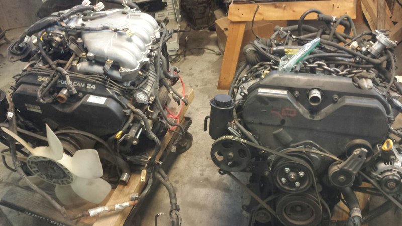

    image.jpg Ok, things coming together now, got the 2004 motor with a little over 100,000 miles ready to go to
    replace the 1997 engine that has 490,000 miles, both engines side by side to
    swap all the parts using as many of the 2004 parts as possible.
    Being safe and having the complete engine resealed from valve cover gaskets to rear main seal and front seals, timing belt, tensioner pulley , idler pulley, water pump, water pump pulley, All belts, most vaccuum hoses and installed stainless fuel line
    for supercharger and a new clutch, resurface the clutch plate.
    Changing the supercharger oil, and power steering oil, engine oil, spark plugs,
    Spark plug wires.
    Yea there a lot to do on a motor swap but a much better choice with this many
    miles than just replacing the head gaskets I see now.
    The hard part was finding an engine that was not a junk yard engine
    (I don't trust the junk yards with the miles they claim un less in the truck still)
    with legit miles that I could carfax to verify the miles and be able to
    hear the engine running that was a low mileage motor.
    Should be all done this weekend!!! and go to go for another 400,000 miles,
