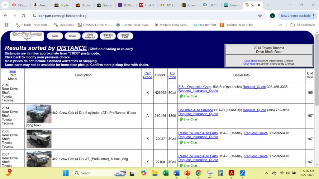

    I was looking at this 2014 to go grab its driveshaft. Like stated above, a lot of solid engines are out there!
