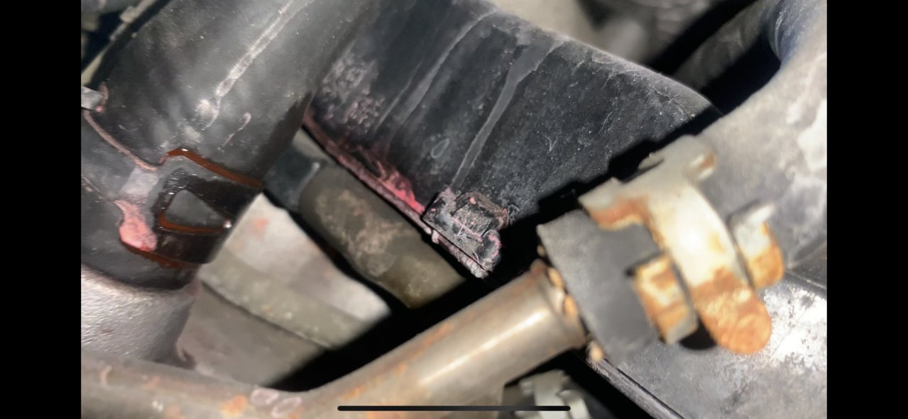

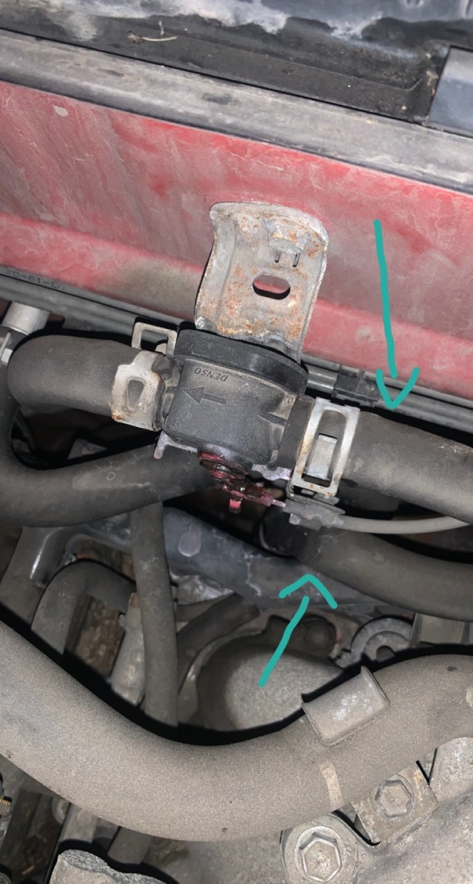

  16. May 28, 2021 at 4:31 PM
    #16
    dashing
    dashing [OP] Member
    Dec 24, 2020
    #350598
    23
    Dash
    Anchorage, Alaska
    2002 SR5 V6 Xtra cab Long bed
    Ok big update... I've located a coolant leak that is thankfully outside of the engine. Picture are below, but basically, the leak is between where the coolant comes out of the engine and goes into the cab to the heater. I believe the leak is where the hose clamps on to the engine. Thats the highest I've been able to track it to anyways. Right off the bat I'm relieved that it doesn't appear to be the heads, but the leak is close enough to the engine that I'm still apprehensive that there could be a bigger problem. Is this a common leak? Should I still be worried about the heads still or should I just swap the hose and forget about it? Sorry these photos aren't amazing but it is a challenge to get a good picture from behind the engine. The arrows are just pointing to the hose that's leaking, and the other photo is of the actual leak. You can see the red coolant around the hose clamp on the far left of the close up photo.

  17. May 28, 2021 at 4:44 PM
    #17
    Black DOG Lila
    Black DOG Lila Well-Known Member
    Jun 14, 2019
    #296344
    9,116
    Virginia
    2003 Tacoma SR5 2.7 5 speed 4WD
    Stock. EZ pass.Dump pass.Inspection sticker.Convict printed lic.plates.FG cap.
    Heater core flow valve is leaking.
    It's amazing you couldn't smell that.
