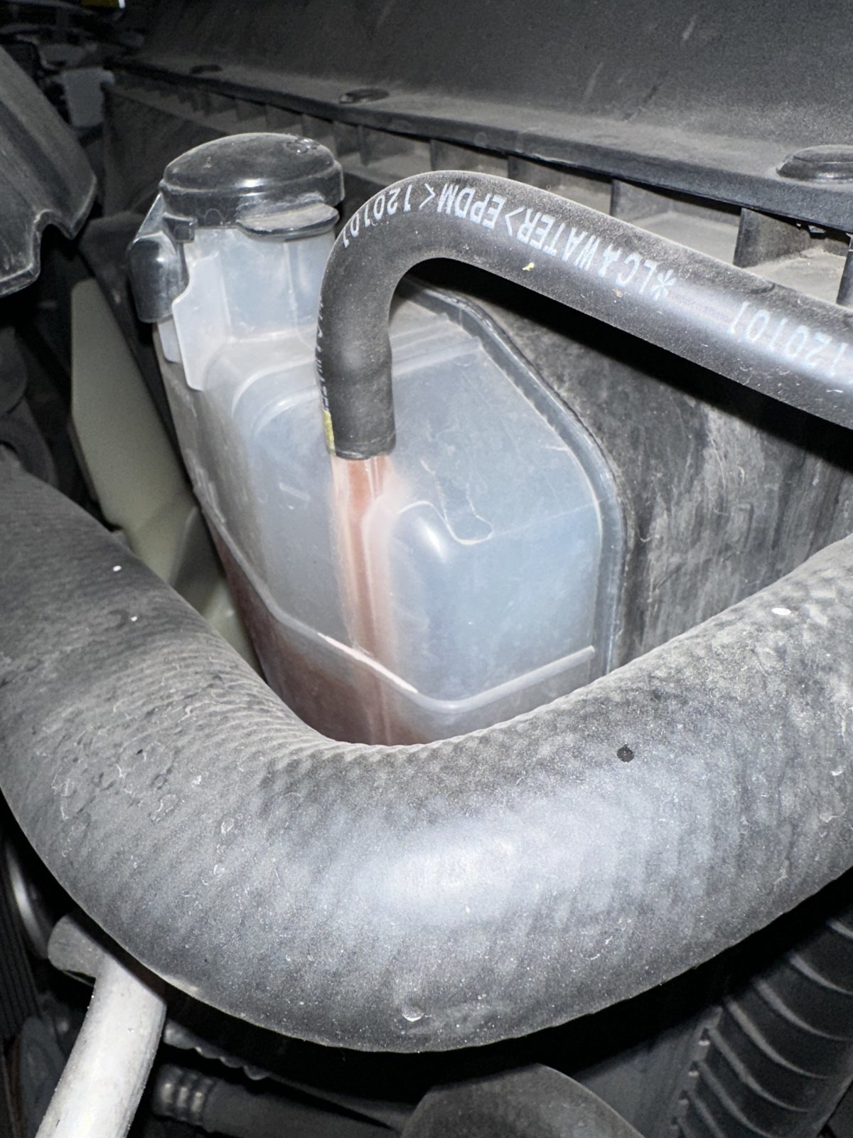

    Is it looking like i need head gaskets?
    •truck runs rough at first until warmed up (expansion causing resealing?)
    •coolant is lower than should be ( its sipping coolant trough exhaust maybe)
    •light tufts of white smoke from exhaust on first start up
    •pretty sure i can smell the coolant burning during idle
    any thoughts? Most likely head gaskets?
    my truck is at 120k and i take meticulous care of it and complete every maintenance at or before the interval.
    ig this is the famed “Toyota reliability”, at this point why not just drive a Subaru if im gonna deal with head gaskets at 100k

    Using the coolant reservoir as a “gauge” isn’t ideal.
    How is the level in the radiator?
    I’d do a leak down test on the cylinders.
    Or a combustion gas test on the coolant.
    Maybe pull the plugs when it’s cold and look for signs of coolant in the cylinder(s).

    Looks full to me, is the radiator full?
    Have you added any coolant?

    The level in the overflow bottle will vary depending on temperature, I wouldn't be too concerned with it yet.
    If you suspect coolant getting into the cylinders pull all the plugs, pressurize the cooling system with a cooling system tester, let it sit for several hours and look for coolant in each cylinder.
