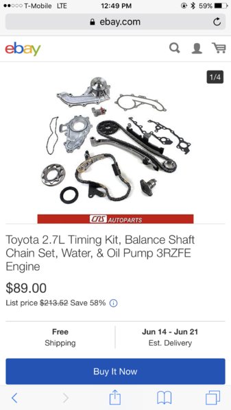

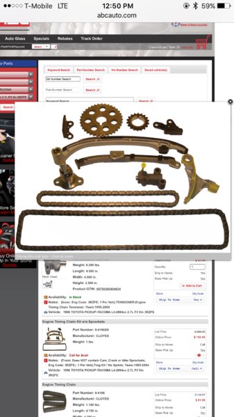

    Also looking at doing a timing chain as well. Will both of these options work? Is one better than the other?
