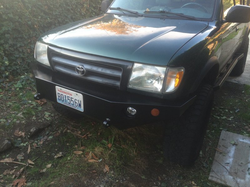

    A little before and after for those who like visual aidsimage.jpgimage.jpg The right side actually looks a little dingy, but it's actually dust inside the housing, too lazy to pull it and clean it.
    They are holding up nicely after a couple months. You can tell the surface is glossy because of the clear coat, the dirt adheres and water beads much differently then when it was pourous plastic before the urethane application.

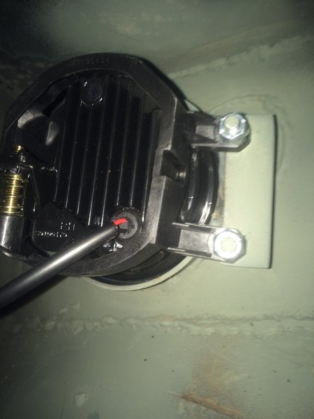

    I went with what they then called the Type T (t for Toyota, and at that time they only had 2 types of them) and they were only $75 in the clearance section instead of $150 because they had a defect, one I simply haven't been able to find. Honestly, one of my favorite things I've bolted on to date. I think they're just called Toyota style now, but honestly, it's more about the way you choose to mount them. I had to make my own brackets. image.jpg My bumper and the light mounting was all fabbed by me so I could really be as creative as I wanted.
    The retrofit source has so many options for their led fogs now based off different vehicle manufacturers I'd just find out by the schematics they provide for each light what will best suit your needs
