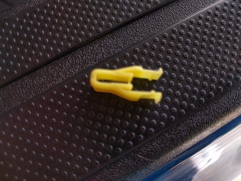

    I suffered with a loose head unit for 5 years, since first installing my aftermarket HU. Recently (as I'm getting ready to sell it) I found a post about taking the yellow clips off the OEM bezel. Luckily I still had my OEM HU so I dug it out of storage and found.... no yellow clips. No idea...

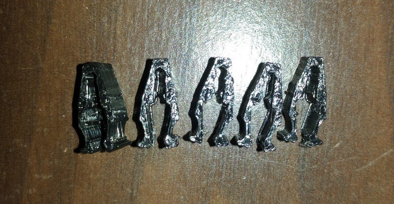

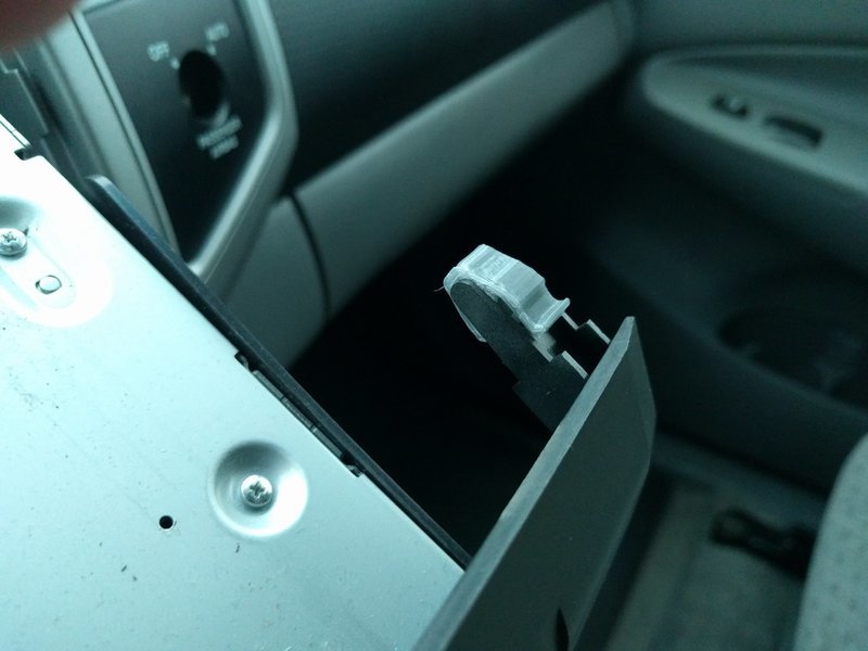

    Well I have a 3D printer, and tired of printing Yoda heads, I've been printing usable parts lately. I found a Volvo clip that was similar but it was too short and too fat. Edited it up a bit and presto.

    Original (found one holding the cup holders in today while cleaning).
    3D Replacement (they are NOT that bad, bad light I swear)
    First prototype (too short)
    No more bouncing head unit!
