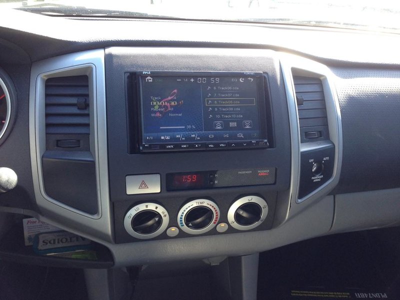

    Installed the Pyle 7" Touchscreen display, dash kit and 4 Pioneer TS 3Way speakers today:
    I would like to add a 10" Sub. What sub/amp setup do you suggest? I'm thinking it would be best to run all 4 speakers and sub off one amp using a separate battery? Any suggestions?

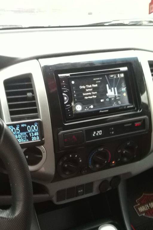

    Nice! This is my head unit. I have a 10" sub behind the drivers seat. Only on 300watts, but it gets the job done and sounds decent for what I paid.
