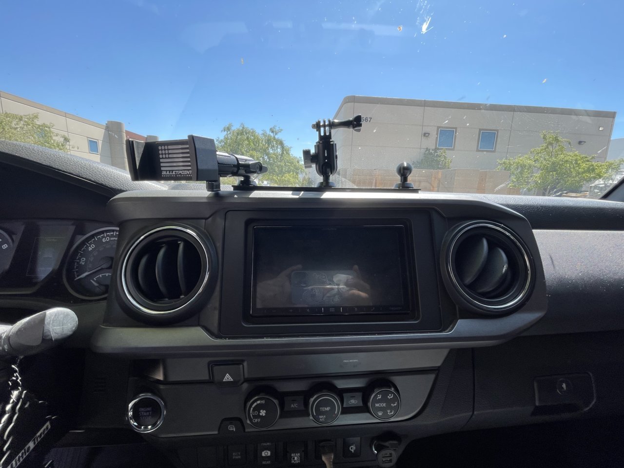

    1.) Pioneer 6600 NEX with all the add on parts and cables at 1500-1600 bucks. Reports show the mic quality can be hit or miss and that some members freezes, reboots.
    2.) The stinger tacoma plug and play radio is 1700ish. No wireless carplay. But does have Xm.
    3.) One of those China Joying Android auto stereos 500-700. But you loose XM and the carplay part requires an app to work. It's not seamless auto start into car play.

    My Kenwood DMX1057XR came in less than the Pioneer with all the components (Sirius, maestro and adaptors). Using the supplied mic has been great (better than OEM by far).
