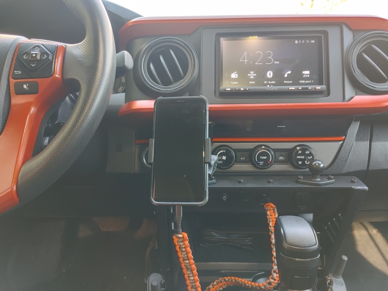

    Did you need to do anything special to get this to fit so well into the space? I was under the impression this was a floating screen.

    @Dupe101 I didnt add anything to the brackets that were supplied and existed. I believe i did grind off a nub on the bracket to get a better fit. There is a white plastic wire raceway in the rear of the unit that the supplied USB C cord was getting torqued against. I removed the raceway. If you use a right angle usbc then you wouldnt need to remove raceway. Did take about 6 installs and removals to get the shown fit before i got irritated baking in the sun.

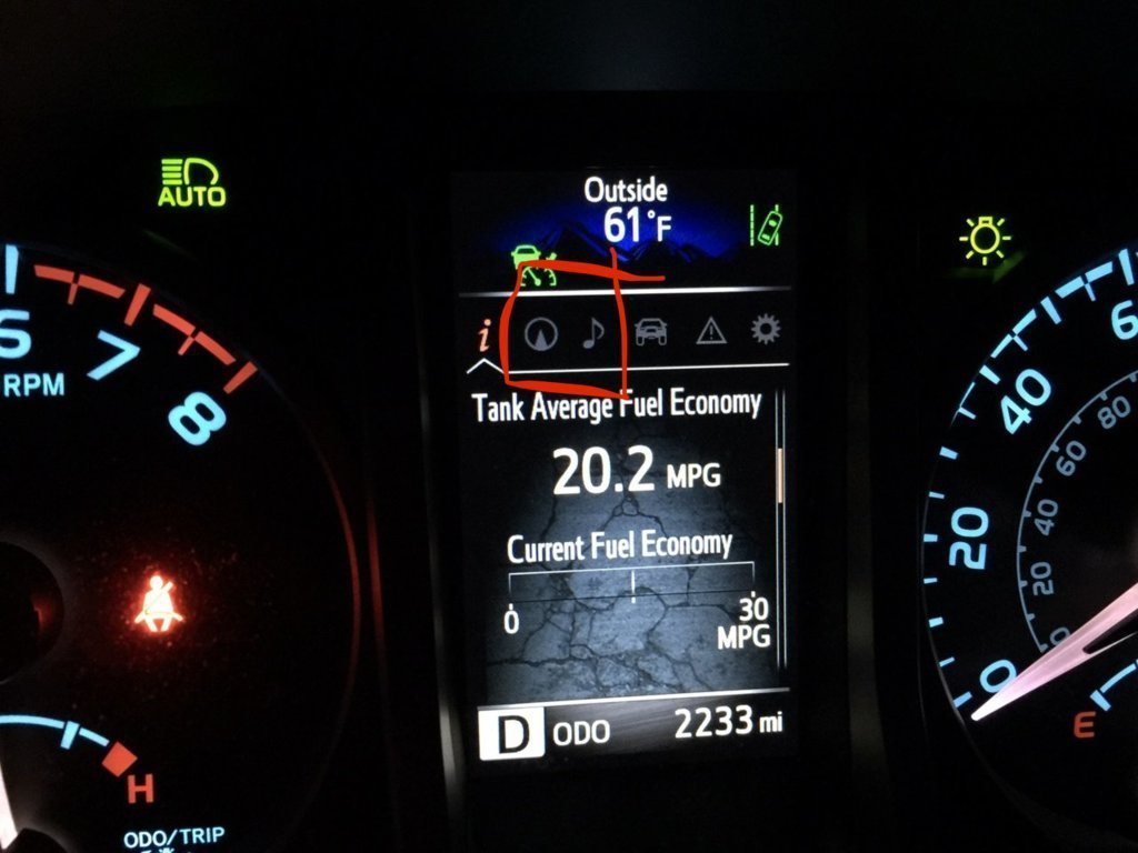

    Cool this the question I wa spooking for if you lose your music display on the dash

    Mine still shows music info. I only lost navigation info by the speedo/tach.
