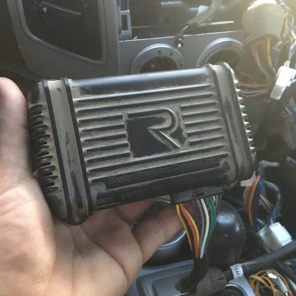

    Alright guys, really need your help. Not sure what is the issue so here goes:
    Got my unit back from Pioneer, password has been removed and they upgraded me to the last firmware per my request. Put the unit in the truck plugged the harness into the back of the deck, powered on when I turned the key to ACC or turned the truck on.
    Unit powers on, boots up fine all menus work, Bluetooth connects, GPS has a strong signal......but I have no sound. I've tried FM/AM, Bluetooth, Aux etc and I can't get any sounds. Deck is showing the songs playing (i.e. Track counting), Pandora shows to be playing and same with FM/AM but no matter what I can't get any sound. I've check mute settings, I've checked att wasn't enable and of course cranked the volume to highest setting and still nothing.
    The unit was reset at Pioneer but I did a reset anyway in two ways:
    1.) disconnected unit from harness and waited 10 mins. Hooked it back up and no changes. As described above all seems to be working on screen but no sound.
    2.) disconnected the truck battery for 15 mins. Hooked it back up but no changes to head unit. ECU certainly reset as I had the low idle where the truck feels like it's barely running. Drove down the road reaching 60+ mph a few times plus a few stop and goes and now idle is back to normal as it always is after disconnecting battery. STILL NO AUDIO.
    I am not sure what I'm doing wrong. I have double checked my wiring and triple checked that I purchased the right harness' to connect from the factory. I used the basic how to audio thread to purchase the wiring harness so until now I was confident I purchased the right harness' and wires correctly but am now second guessing myself? I've done audio installs in previous vehicles and have never had trouble like this. The harness adapter is from Metra and all wires were correctly color coded and as I mentioned above I double checked the speaker wires are connected correctly.
    One note: I did have the factory Bluetooth system which sucked thus why I chose to get a new head unit. There are 2 sets of wires which have a harness that plugged into the oem Bluetooth setup which I've left unplugged. Could that possibly prohibit audio from playing through my new unit? I'm at a loss as to what to do next except to start from scratch. I thought about just splicing some speaker wire to an external speaker and tie that speaker wire into the pioneer harness directly to see if I get any sound but will probably do that last. I'm hoping I just don't have it wires correctly......
    I will be more than happy to take pics with my dash pulled apart to show how I have it wired.
    ANY HELP IS GREATLY APPRECIATED!!!!

    Fixed!!! I thought this thing was the OEM Bluetooth module Bc the mic plugs into this as well and could be removed. I didn't have it plugged in but as soon as I did TADA!!!
