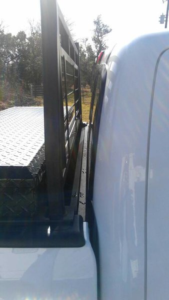

    Hold on and ill get pic of mine

  14. Dec 24, 2012 at 9:43 AM

    07 DC peerunner
    This^^
    I use the crap out of mine,don't have a trade yet.
