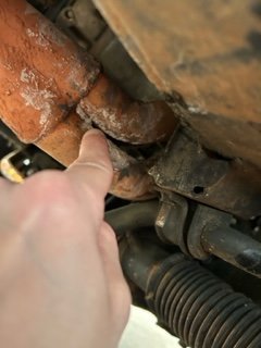

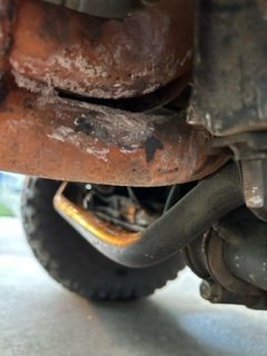

    Says it’s stainless steel tubing. It is cracked where the 4 tubes go into 1 before the collector. Hard to see exactly where. I did the ol’ shop vac thru the exhaust trick to find the leak. The pics attached shows kinda where. Btw, I tried JB Weld high heat and some British Firegum Paste and neither worked. Figured they wouldn’t but gave it a shot.

    That was always an area prone to cracking.
    Any friends that can weld? Already cracked nothing to lose.
    Headers never did hold up in street vehicles all that well compared to racing.
    Constant Thermal Cycling .
    If I was close I be glad to help. Good luck!

    Appreciate that. I do have a friend who is a great welder but he seems to think the location is a tough repair. Guess we could at least try.

    No No !! You need to remove the header !!
    It needs to come off either way. Correct!

    Got it. Haha. I’ll see what we can do. Worth a shot before I drop $500 on a replacement or $200 ish if I go back to stock style parts. Appreciate the feedback.

    You said it was stainless steel, but why is it rusty? Something is fishy here.

    That’s what their site says??? :notsure:

    Some grades of Stainless will rust.
    Seems like there are new grades every month.
