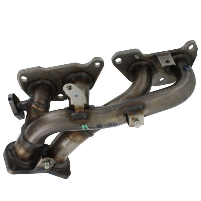

    Yup looks like that's actually OEM for your truck. Older years had an actual manifold (cast) which was notorious for cracking. Thought that is what you were referring to when you said manifold. Mine cracked twice. I will say that OEM engine mounts are a must. I had soft mounts which were aftermarket and that was the issue. Engine swayed too much putting extra pressure on the manifold. Replaced to the mini headers and OEM mounts problem solved.

    I wish I had gone with this one now, cheaper and better but I thought Doug thorley was quality. It's a nice header I'm sure if it had fit though

    That's what I have in my 95 2.7 4x4. direct fit.

    Thank y'all lots for the input! So to recap, the manifold/mini header displayed on PartsGeek.com is a direct fit replacement and you have had no issues whatsoever? I've never used PartsGeek.com but y'all are on top of everything and that's awesome! I only wonder what the difference is between this and the Doug Thorley headers? From the one on PartsGeek.com, has rust been an issue either?

    The shorty header people are talkin about is a factory toyota part. The later years of the 3rz yota dumped the cast manifold for the tubular shorty header. I wouldn't be to worried about fitment issues.

    It's cheaper from the link I sent and it's OEM. Idk about the one parts geek is selling

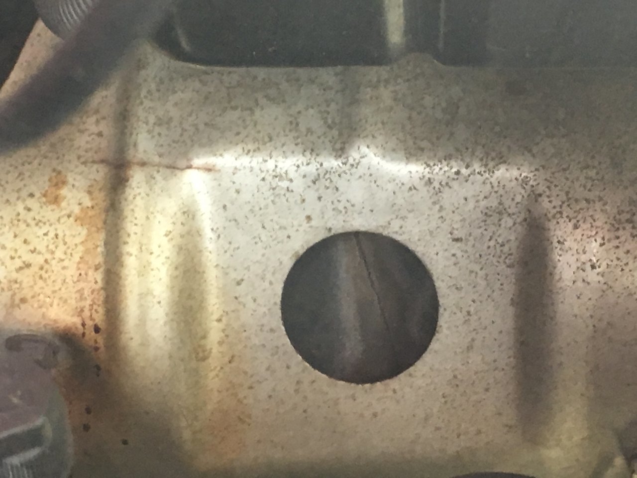

    Would this fit my 1999 2.4 tacoma and how is the performance? as you can see I might have a crack on my manifold
    Thanks
    It states that if doesn't fit my 1999
    Making sure it will. https://www.toyotapartsdeal.com/oem...1=2RZFE;5=ATM;6=4HC)&Location=manifold,,17141 This states that it will but not sure if it's the same material

    So I'm not 100% that the 2.4 is the same manifold as the 2.7. I can look into it for you. The mini header I linked there was for a 2.7 but if the manifold is the same then I don't see why it wouldn't fit. I mean the site also says it will not fit my 1995 2.7 but it was direct fit. Reason it says it won't fit for me is because those didn't exist back then for the 2.7 so the OEM part number is cast iron.
