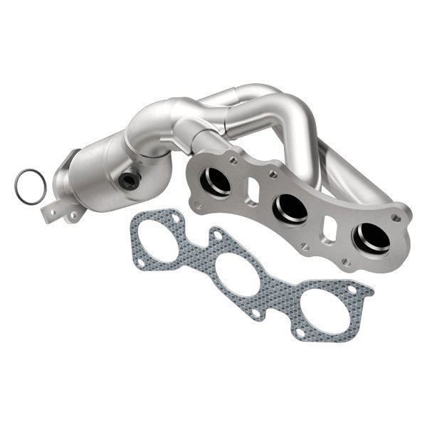

    I've seen a couple of posts about these (Magnaflow) but nothing to say anyone has installed them or is happy with them. I bought a set yesterday because the cat's are included and I'm hoping these bolt up and require little to no fabrication. I want to stick with the shorty header for the torque and keep the cat's to avoid throwing a code. These and the fuel pump/filter and radiator upgrade are in preparation for the blower installation...
