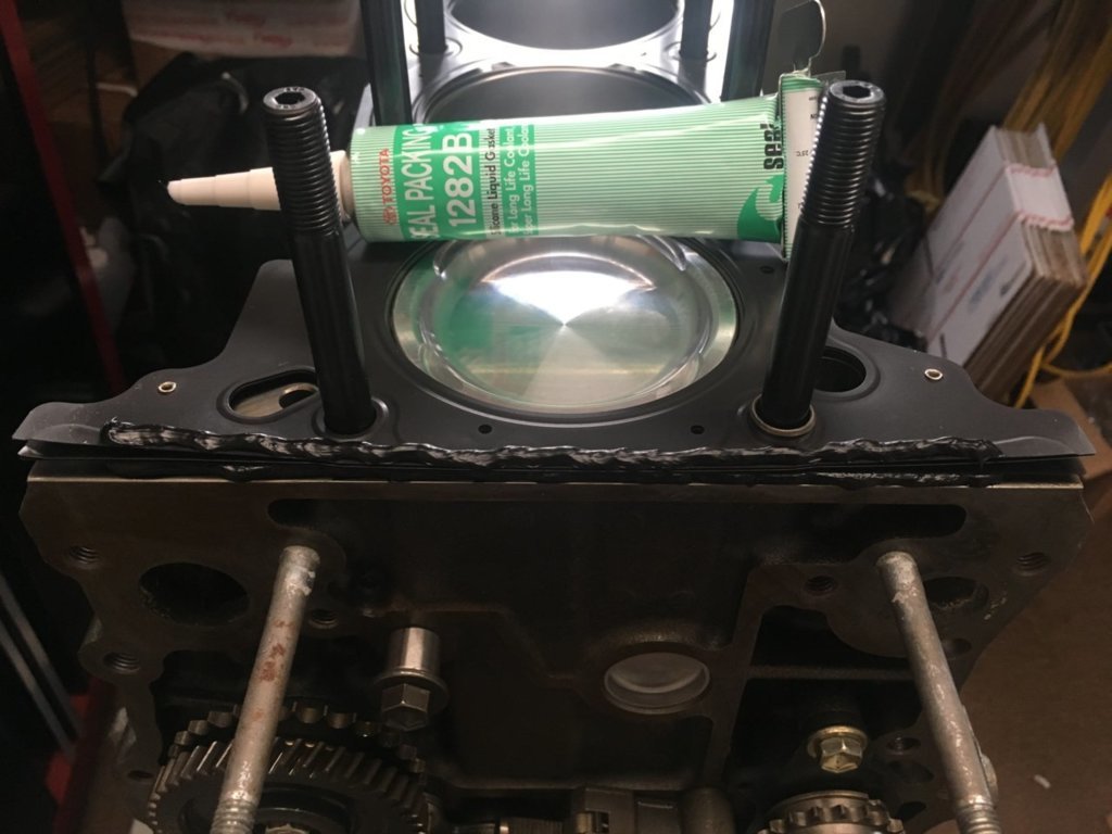

    -i also put a bead of Toyota Seal packing under the very front of the head gasket which i read on the forums here. But made me feel really uneasy. I've never seen a car call for sealant to be on the head gasket... IDK my gut tells me this Toyota Seal Packing stuff is ruining the compression.

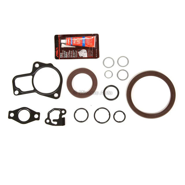

    The first picture (from Mizumoauto.com, I've never heard of) has them all.

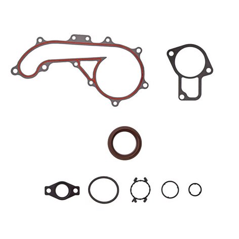

    The second picture, Fel-Pro kit, is missing 2 of them?
    Also does anyone know what the last little gasket is with the 4 outer nubs on it?
    I did not use it on my install, and never saw it used in any videos.

    1) For the sealant you want Toyota part number 00295-00103 also called FIPG 103. Use this, or Permatex Ultra Black. I still think the FIPG 103 is better, but you have a time window so it's a little more pressure to get it right.
    2) You don't need to remove the oil pan for a timing cover job, if the oil pan isn't leaking leave it on. More than likely, the issue is that the bottom of the timing cover did not seal properly and gravity and oil have won causing oil to leak from the lower timing cover around the oil pan gasket, making it look like the oil pan is leaking too. I would spray it off with some brake-cleaner, and then have another look. Oil pans and timing covers are separate jobs on a Toyota. Doing one should not cause the other to leak. When you go to redo this timing cover you need to make sure that the mating surface of the timing cover, where you the apply sealant, and the area that is sits against are as clean as possible. Wiping the surface with isopropyl alcohol and a clean cloth will do it, but you need to remove all of the old gasket material, without gouging/scratching the mating surfaces. The sealant will only seal minor scratches, anything that catches your fingernail is enough to cause an oil leak. Get a set of plastic razor blades or use an old plastic credit card to help you scrape away the old gasket material. If you have air tools, a die grinder with a green bristle disc is the fastest way to do it without scratching anything.
    3) Those are totally different gasket sets, you need the gaskets specific to your year, model and engine. Best advice is to take your VIN number and go to an online OE toyota parts dealer and look at the cooling system pictures, you will see what gaskets you need and the Toyota part numbers for them. You can take a short cut and get most of the OE part numbers from the aftermarket gaskets sets that you are looking at, they should list the OE parts numbers that they are matching with their aftermarket one. Using the online parts dealer, and your VIN number, you can check the part numbers in the gasket set and verify if they match your VIN, then you know exactly what gaskets you need for job and if the ones in the set work for your vehicle. Also, I would not buy aftermarket gaskets for an engine job, just my 2 cents.
