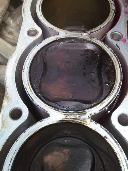

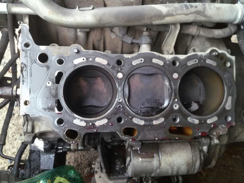

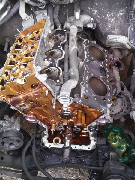

    Normally head gasket fails between cylinder 4 and 6. I replace mine at around 160,000 miles, also had to replace both cats because of all the missfire it was having damaged them.
    Good luck.
