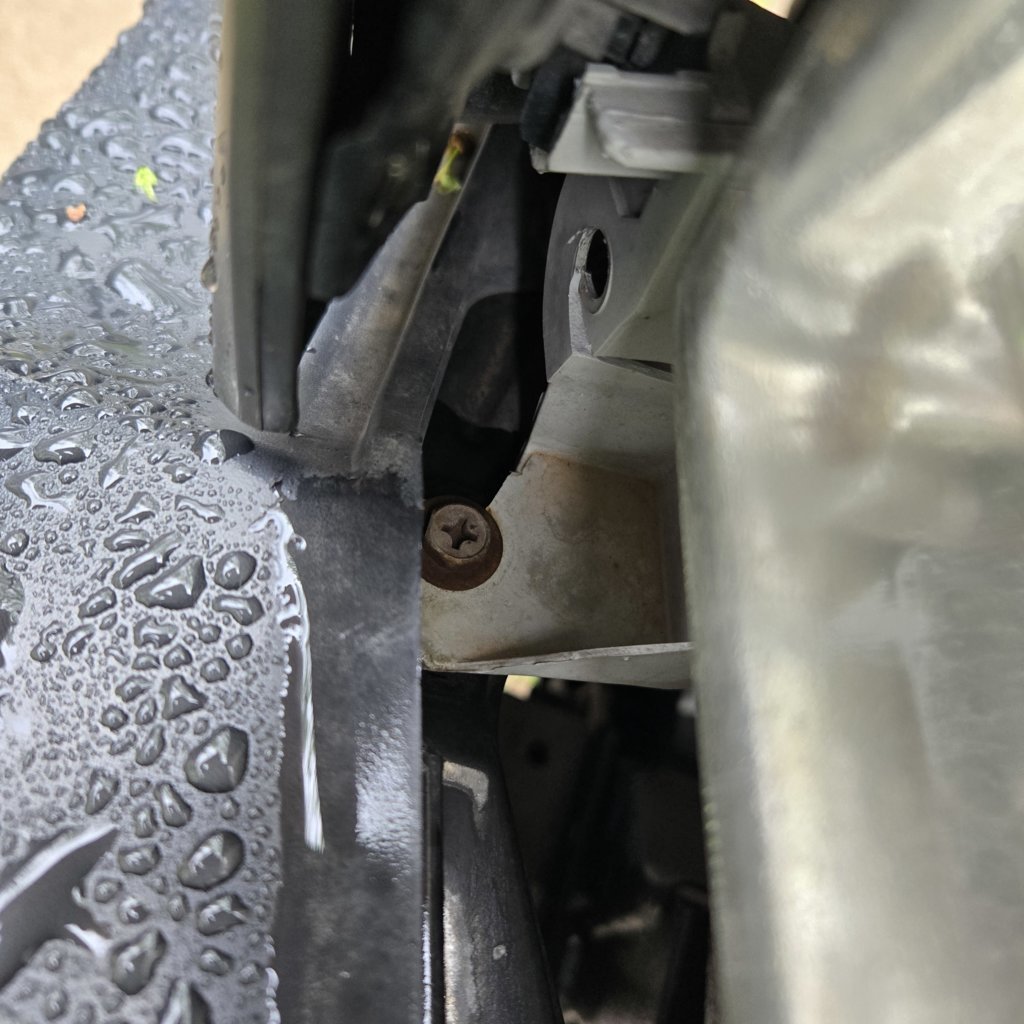

    I attempted to do mine. At some point I realized I was going to run out of daylight before figuring out how to get that last fastener off.
    It’s a bunch of crap to remove to get to them but I think the bumper cover stays on.
    I scoured YouTube for an instructional video. They all skip over getting that one fastener. I do remember it’s a good idea to have some masking tape to help prevent scratching something.
    I know it sounds odd but closing your eyes and sticking your tongue out helps getting at a blind fastener.
    Keep in mind “book time” is based on one guy who spent the last 10 years doing just that one task so he’s really good at doing it fast and has every possible tool necessary. So yeah, it’s possible for that one guy. A professional mechanic can possibly get close. A backyard mechanic with access to fewer tools probably not. So don’t feel bad if it takes you longer.
