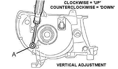

    a) Adjust the aim vertically:
    Adjust the headlight aim into the specified range by turning aiming screw A with a screwdriver[​IMG]

    Here is a diagram of where the up/down adjustment is. On my 2011 there is a slot formed by two plastic ribs above the nut with the 8mm head. A philip'shead screwdriver fits down this slot and into the nothches of the adjustment head. The counter clockwise turn to lower the light is for the screwdriver (the adjustment head will turn clockwise). If you use an 8 mm socket to turn the adjustment head twist it in a clockwise direction to lower the headlight beam. Head light Adjustment.jpg

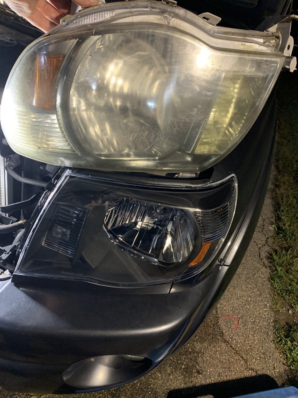

    How many twists are allowed? I just put in some BROCK headlights from Partsgeek for $130 and it seems like the adjustment screws on both are just decorations .

    Not uncommon for adjustment screws on aftermarket assemblies not to work, or break when turned too many times so that they no longer work. I'd definitely recommend OEM.
