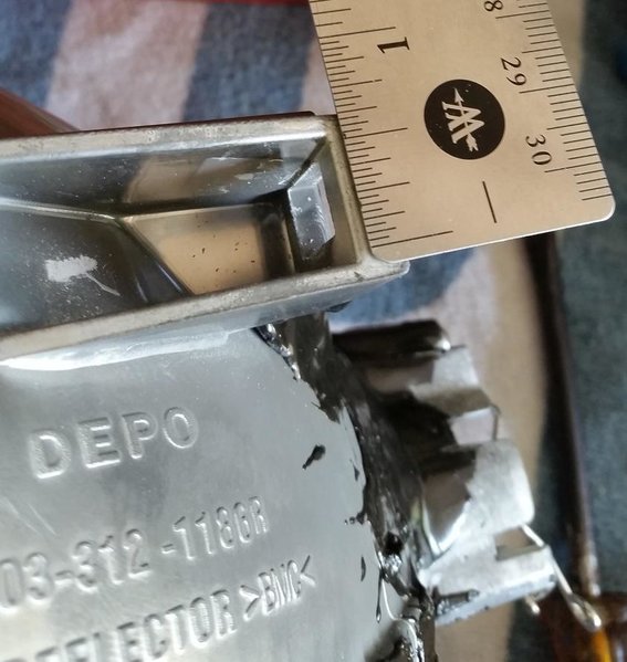

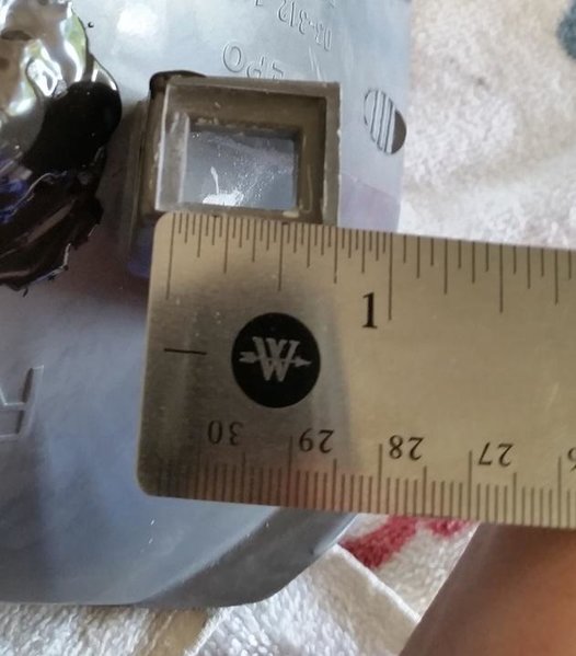

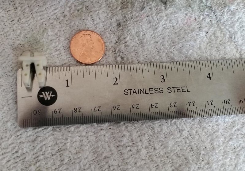

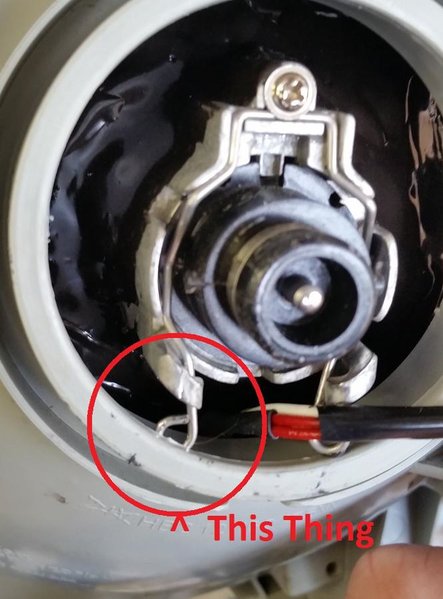

    For my issue, looks like the plastic part for the headlight adjuster was stripped (cheap a** plastic). If you haven't taken yours apart yet, I snapped a couple pictures for you. That way you can head to the auto parts store and look for a replacement. :D It looks like it's threaded 10-32. In a pinch, I suppose you could find some 10-32 nut and jb-quick it to the housing. Hope this helps.
    Edit: Looks like I found out why mine stripped. As I was adjusting, I couldn't see the clip that holds the HID bulb in. It got caught on the inside of the housing.
